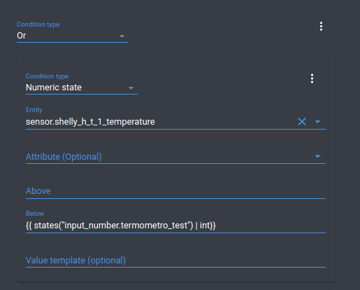

I think you can do this also via the UI like this:
Theoretically, the first one should have worked because a Numeric State Condition does support assigning a Helper (such as an input_number) to its above and below options. Here's the last example from the documentation:
condition:
  condition: numeric_state
  entity_id: climate.living_room_thermostat
  attribute: temperature
  above: input_number.temperature_threshold_low
  below: input_number.temperature_threshold_high
The other two are invalid because it does not allow its below and above options to have templates.

First of all, thx for the help.
I tried several things in the UI, and it seems that whenever you put something in Above or Below that is different of an actual number, you get error messages and nothing is saved to automation.yaml (this happened both in device and in numeric_state)
The Template solution worked straight out of the UI. It behaves a bit strange because it does not fire when the trigger happens but about 20-30sec later. This is not a problem in this case, but I can imagine that this could be an issue in some aplications.

What does the error say when you use numeric_state and put input_number.termometro_test in below over the UI?
I made some additional tests on another automation I had (didn’t wanted to mess with the currently working one) and there I had no issue in using “below: input_number.termometro_test” directly in the UI.
This however only works when using a “numeric_state” instead of “Device”. If I do this in “Device” I get the following error: “Message malformed: expected float for dictionary value @ data[‘below’]”.
The issue I had of taking 20-30seconds to trigger also disappeared and is now instantly.
