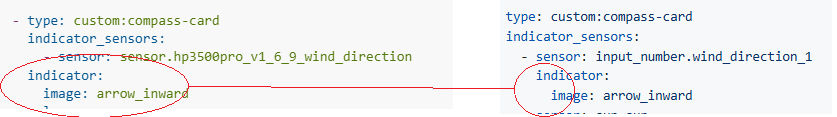

You need to add some to that yaml, you must add 2 lines for each sensor, the indicator and the image, see the section:
An indicator config must be provided and specifically below that:
This has to be expanded to

You also formatted wrong:
