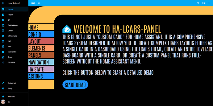

First off, let me say the LCARS Theme is awesome and for most of you who want to Trekify your HA dashboard, it will do everything you want. For those of you who want a more complete LCARS system, I built a custom card/panel that lets you create extremely complex LCARS layouts and navigation. Right now, it only has read access to HA state, but interactivity is coming soon.
First release is now available on GitHub and there are installation instructions and a link to demo configs (including the one shown below) and a full walkthrough.

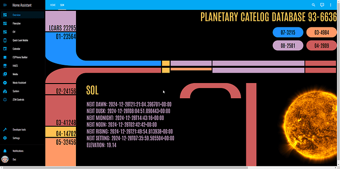

Hello there. I am trying to get this to work using your sample yaml. I have added the demo and sun yaml and have added the .js and .css file. The demo page seems to load fine. However, the sun page is a bit out of whack. Can you advise what I should check to fix this?? Thank you.
demo:
sun:
@duceduc It looks like there is a glitch with the panel-all component. If you wrap it in a col this should be fixed:
          - type: col
            children:
              - type: panel-all
                config: ...
