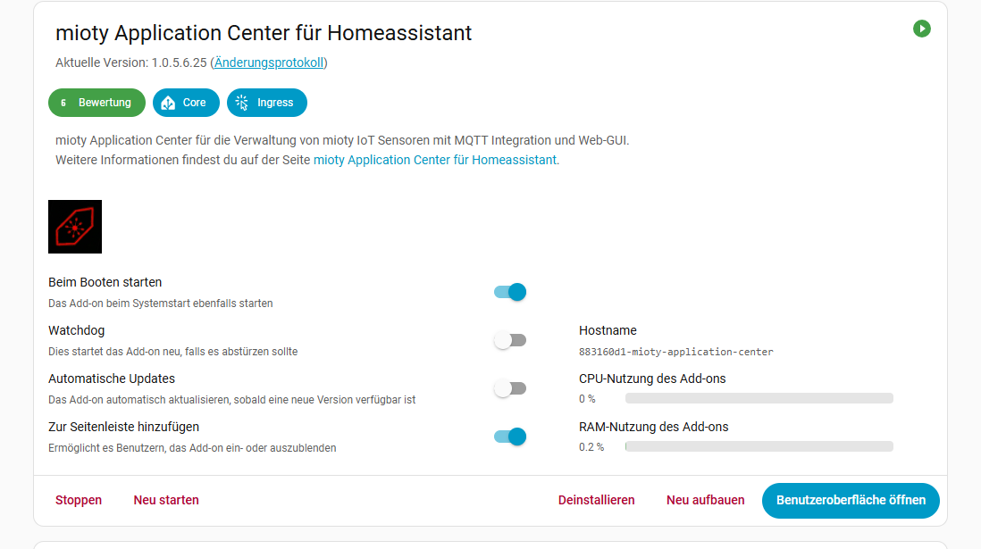

The applicationcenter you can directly insert in homeassistant as custom addon and you will receive future updates from the service when there are some.

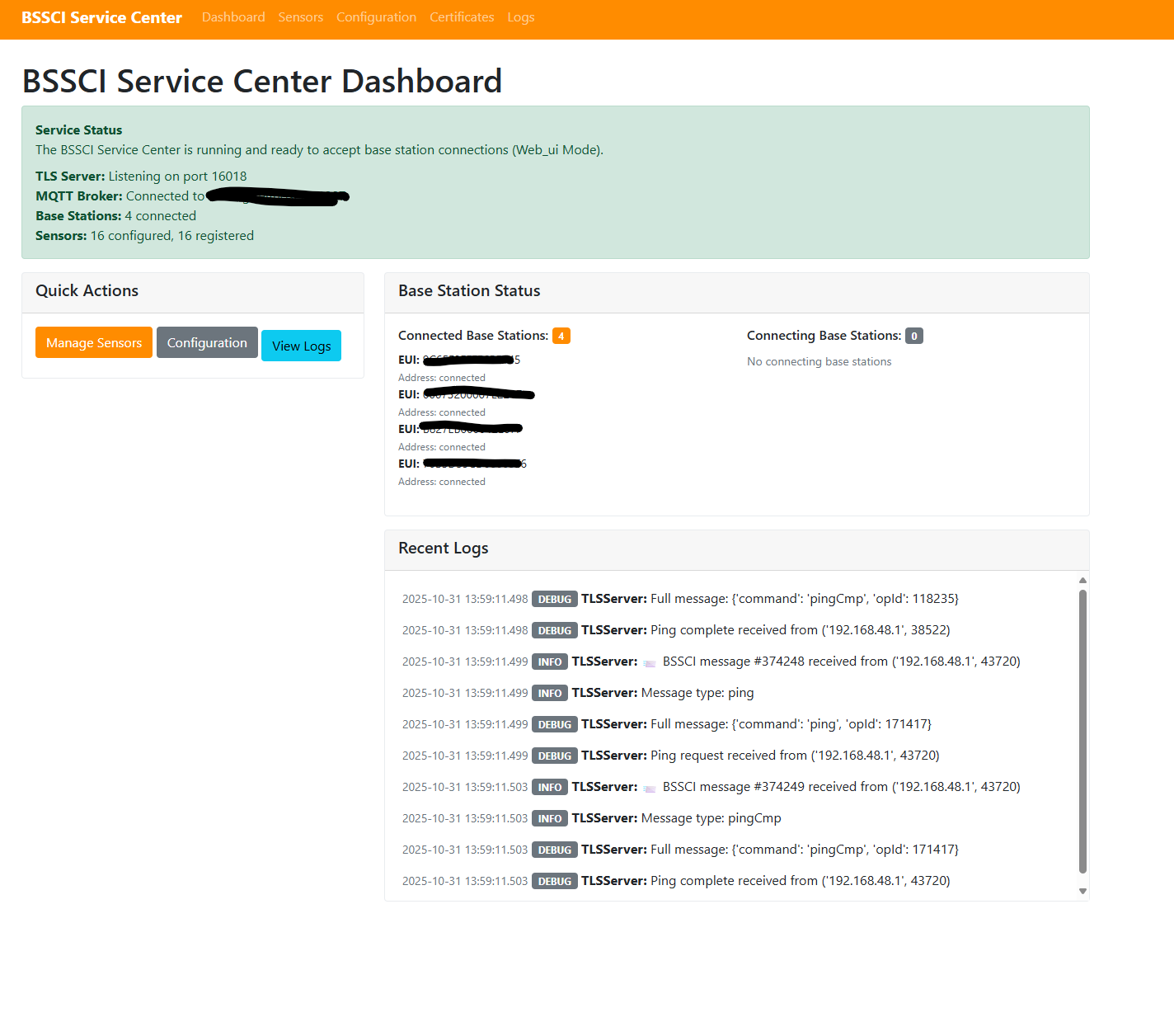

The service center comes with an UI to configure and bugfix everything quite easy:
You will find different dashboards to also change settings for the mqtt broker and the BSSCI interface which is the standard interface from mioty.

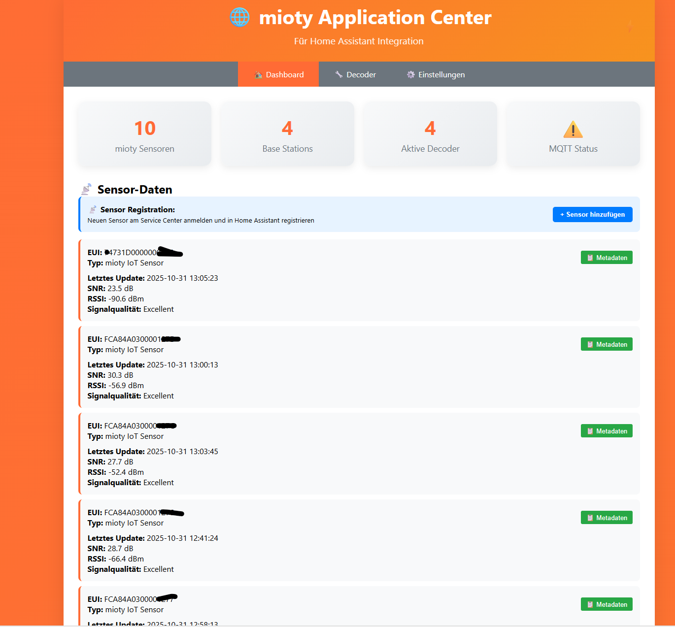

The service and the application center are for easy trouble shooting connected through an mqtt broker, there you can see easily whats going on and if the servicecenter is working fine.
Afterwards the data will end up in homeassistant and will have the right payload decoded automatically, if you have an right payload decoder. at the moment, I focus on sensors from sentinum.de; because they solve many applications I have at home. Therefore the parsers work perfectly.for this setup. but you can surely add other sensors as well, we will have to fit them in than :slight_smile:
