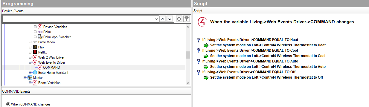

After researching for hours, I stumbled on the itfrosty’s original Home Assistant post, and noted that he called out that setting HVAC state wasn’t working. I had the thought of using the Web Event Driver (link below) to call in to Control4 a different way, but looking at his most recent commit on the Home Assistant component, he had already done this in a hard coded fashion for his setup. So I took that code, and retrofit it in to mine. There are some changes to the properties to support this. My configuration now looks like this:

To manage the Web Event commands, some programming had to be done on the C4 side:
Here’s a link to the Web Event Driver I’m using:
https://untestedhacks.com/2013/web-events-driver/
