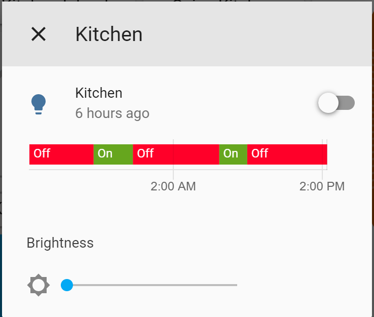

A set of custom components to allow integration of Control4 lights, thermostats, security systems and media volume into Home Assistant!
Full details in the GitHub repository: https://github.com/lawtancool/homeassistant-control4
This is currently very beta stage, but appears to work reliably with my setup. I’m not exactly a programmer and mostly cobbled this code together by copying other Home Assistant components, so contributions are welcome!
Currently working:
Lights: on/off, brightness control
Thermostats: ambient temperature display, mode display (but not changing), target temperature changing
Security System: view state (Disarmed, Armed Home, Armed Away)
Media volume: change volume of media in a Control4 room zone
