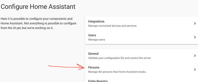

I’ve included person: in the configuration.yaml and rebooted, but I cannot find the web gui. Could you give some more information on where to look for it? Thx.
I did not have this menu option, reset of browser cache did the job.
