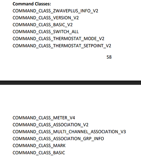

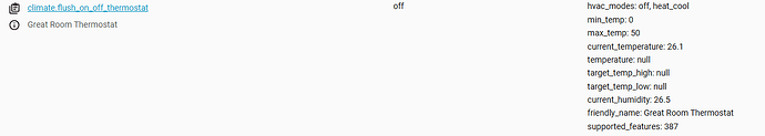

there are the attributes that show when I look at the entity states in HA. I don’t see hvac_action there. Is there some other way to see if it exists?

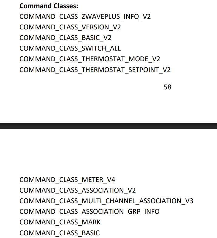

No, your thermostat simply does not have a THERMOSTAT_OPERATING_STATE command class so it won’t exist unless the manufacturer adds it.
This is from the manual for your device, showing only support for thermostat mode & setpoint
And this is an identical issue with a different device which explains that this is where hvac_action comes from Heatit Z-TRM2fx Z-Wave thermostat missing hvac_action attribute · Issue #133357 · home-assistant/core · GitHub
You have no other option but to use your hacky way to determine if your thermostats are currently calling for heat.
