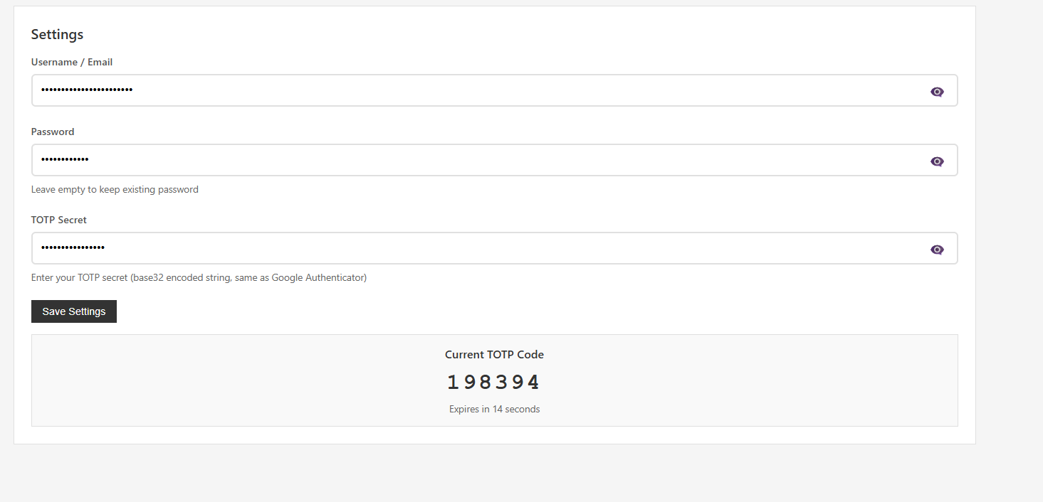

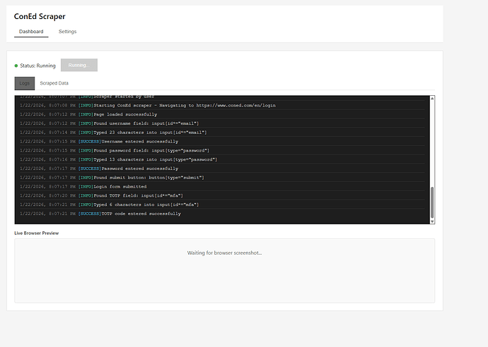

But it sucks so much doesnt return enough data so i decided to embark on a journey to make a con ed scrapper and its turning out well had to start from scratch serval times but figured out totp so it matched google authenticator and can generate its own matching codes and use them for login page ect, was able to login now just a matter of properly scrapping pages for data and downloading pdf bills.

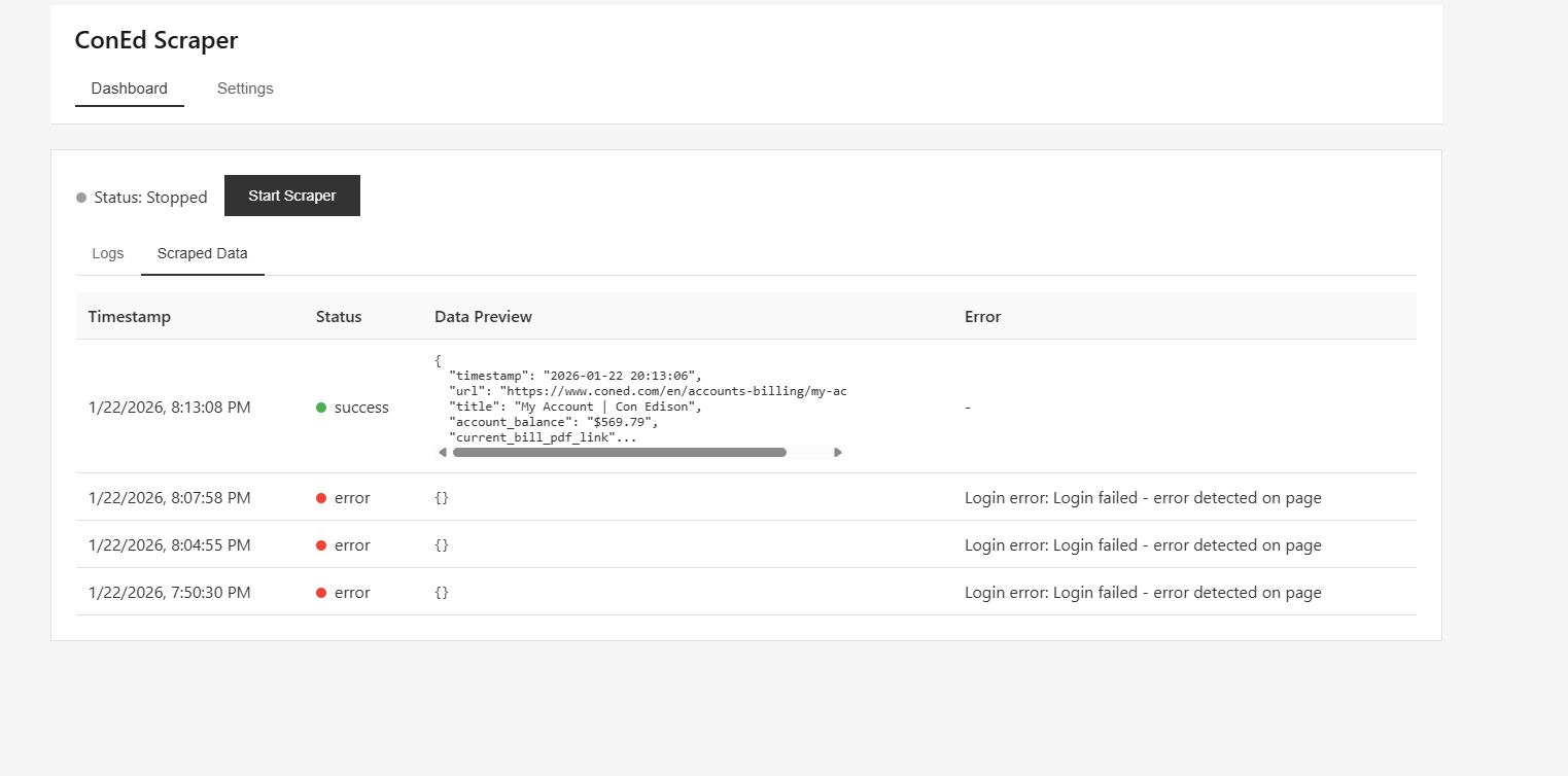

So far i acheived my goal its running as a web app on seperate server sending mqtt updates to sensors but i need it as a addon after i polish it up.

i have it setup as webpage dashboard for now
