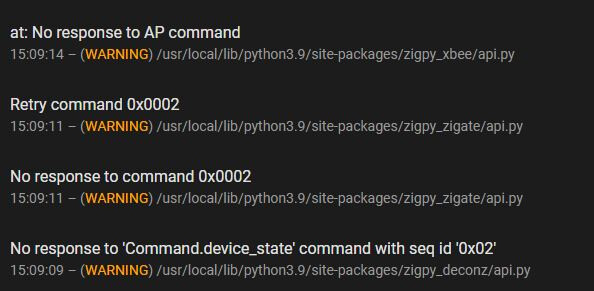

I’m running HassOS in a proxmox vm. I’ve tried passing my stick via every option possible in proxmox, all have the same result, in the logs I can see the following:
Could anybody help me further?
