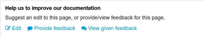

That’s no complete reference. Only parts that are explained. I mean something like this
If you scroll to the bottom of the page you will see this:
I only have two words on that topic Tom… Sunrise/Sunset :laughing:
