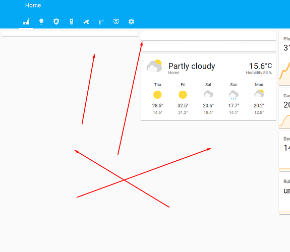

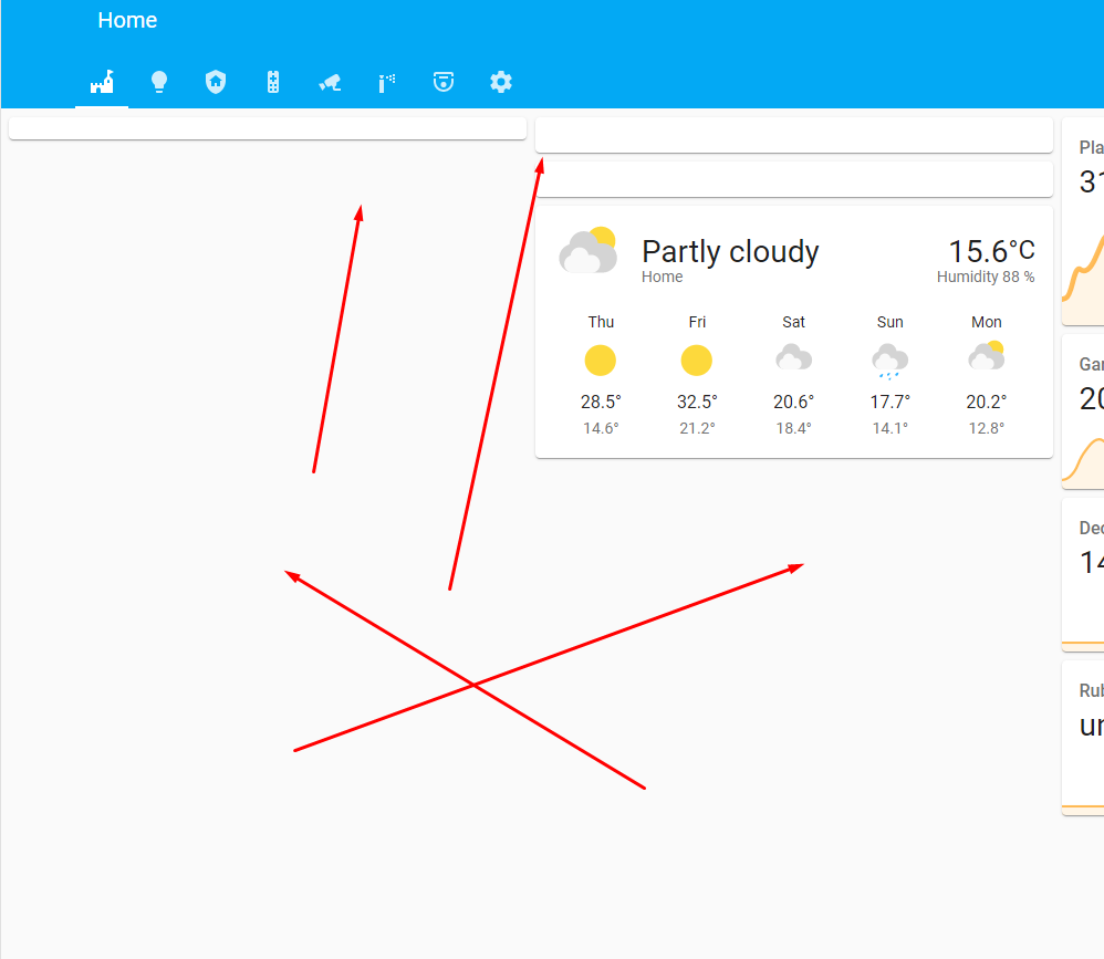

Did anybody find a solution to this problem? I am getting an empty space for every card I am trying to hide via a conditional in a horizontal stack. The card is not showing, but there is an empty space instead. I would expect the hard to be fully hidden.

The easiest way is to fill the empty space with another card.
Another way is to have “dynamic” width of cards - actually I would be interested in this solution as well.
For me the issue only happens in a browser window, not in the Android app, so I just deal with it… not a solution but I gave up trying to find a solution because it seemed there wasn’t one
virgilm
September 6, 2020, 12:28am
38
Thanks @sparkydave ! Yeah, same here, it happens only for specific sizes of the window (mine is a horizontal). Is there a bug ID for this, it seems this issue has been around for almost 2 years?

I am having same blank issue around filter entity cards in chrome on deskop as well android app is fine. Looks pretty terrible.
There doesn’t seem to be any way of fixing it. At least not that I have found
