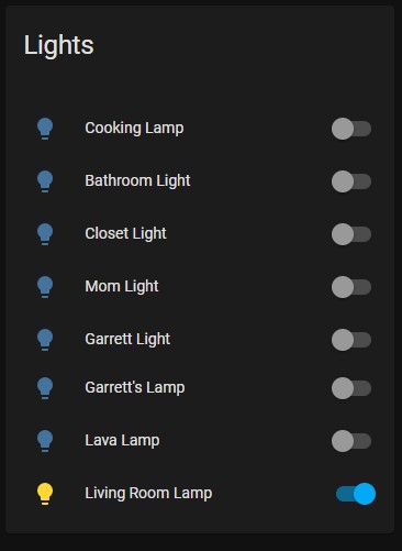

Conditional card leaving space in GUI

I would guess this happens, because the conditional card is part of a display: grid; parent. It might be solvable by using custom:mod-card and make the display: grid; parent a display: flex; one…

Still experiencing this issue. Showing additional padding when the conditional card is not present.

The latest version of home assistant using the new “visible” tab seems to do the trick for me. I’m still using my conditional cards inside of another vertical stack (don’t know if that’s necessary, just being lazy). Once I set up my same conditions on the “visible” tab it removes the space when the conditions aren’t met
