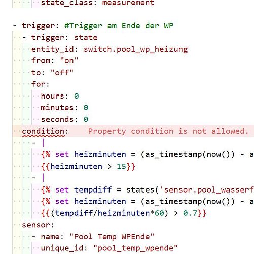

I’m trying to create a trigger based template sensor which is only triggered when a condition is met.
“condition” is listed as a configuration variable on the Template configuration page and there is even an example YAML code for a trigger based template with a condition. However, when I create the sensor in my config, I am getting the error “Property condition is not allowed”. Even when using the example code from the template configuration page gives the same error.
Has there been a change to the way conditions are set for a template sensors? Is there another way to achieve this?

Yes, condition is a valid configuration key for trigger-based template sensors.
That “error” is coming from VSC/Studio Code’s extension, not HA. If your extensions are not up-to-date they will not reflect the actual current schema… and it is pretty common for the extension to lag behind HA updates.
The current version (5.18.1) of the Studio Code Server add-on does not show a warning for condition.

I use 5.18.4 and the warning is still there
Please review #11 and #14
VSCode needs to be updated to account for condition in template entities. Just ignore the error, it’s valid if you’re using the latest version of HA.
