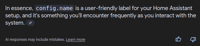

That’s expected behaviour. Can you link to the documentation that says you can access the config via Jinja templates like you are trying to?
If some sort of AI robot has imagined it, then please remember the small print at the bottom:
I’ve been using HA for over five years and have never encountered it, although I have encountered many situations where people have mistakenly trusted AI guidance.

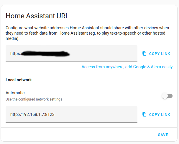

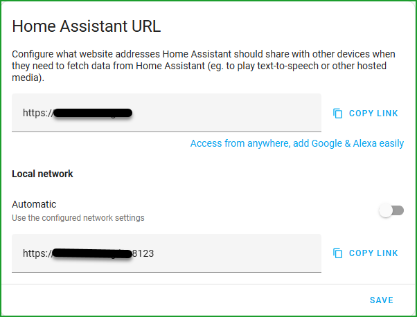

Does it show up correctly under System / Network in the UI?
Yes, that’s exactly where I filled it in.

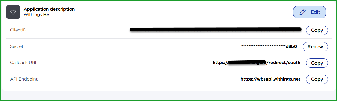

Thanks Edwin for your comment, but of course I entered my own URL when creating the Withings app.

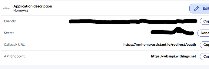

Don’t use your own URL. My working setup for reference:
Entering your own URL when creating the Withings app is not what the docs ask for. It asks you to enter the https://my.home-assistant.io/redirect/oauth url. Then Withings redirects you there, and that will redirect to HA again. I followed it to the letter and it worked perfectly.
