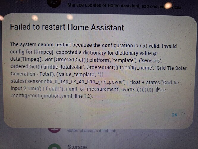

when I try to restart HA I get an error
attached is a picture of the code in config.yaml and also the error on restart
any help appreciated!!
One thing I see is you misspelled “default_config”
Also, I think you have “gridtie_totalsolar” indented too much.

fixed the misspelling on default, still wont load
I think lines 15-18 need to have 2 spaces removed from each line, they are indented too much. Im not sn expert in yaml, but I think that is not correct.

here is the new error I am getting now
Failed to restart Home Assistant
The system cannot restart because the configuration is not valid: Error loading /config/configuration.yaml: mapping values are not allowed here in “/config/configuration.yaml”, line 2, column 15
