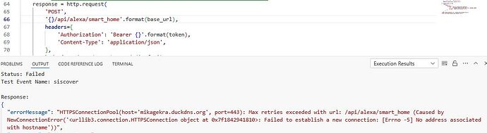

after changing from dsl to fiber with a fake ipv4 i couldn’t reach my homeassistant with the lambda funktion for alexa.
I’ve removed the ipv in duckdns and set ipv6 (manually).
[Errno -5] No address associated with hostname
``` sounds like problems to get the ipv6, maybe he uses only the empty ipv4?
So changing this construct directly to the actual ipv6:

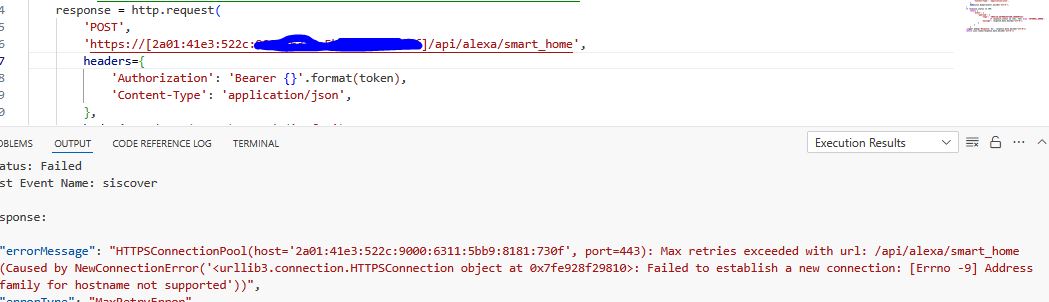

![aws_0|690x198](upload://uCs81Wn2Dur3SCzjnNWQONSLgLr.jpeg)
Failed to establish a new connection: [Errno -9] Address family for hostname not supported
does anyone have a idea, what exactly that means or what i could try next?
Many thanks...
can’ upload second picture in the first message, so here you find the second screenshot:
Address family would be IPv4, IPv6, etc. and in this case its IPv6. My guess is that somewhere along the path from AWS to your HA, IPv6 is being dropped and not making its way to your HA Server.

the first Screenshot is from trying it with the duckdns url.
The second with the ipv6, that is saved in duckdns. The ipv6 and the durckdns url works with my handy (without wlan :wink: )
Ah I see … looking at it and it has a different error. It says there is no (IPv6) address for the duckdns name you used for Lambda. I would suggest you go to this Toolbox from a computer and enter that same DuckDNS name and see if it resolves to an IPv6 address.
As a check, are you sure the IPv6 address you are using is the one that will reach your HA Server? Could it be that that address is your router’s WAN IP address instead? Is your router doing IPv6-IPv6 NAT? those types of things.
