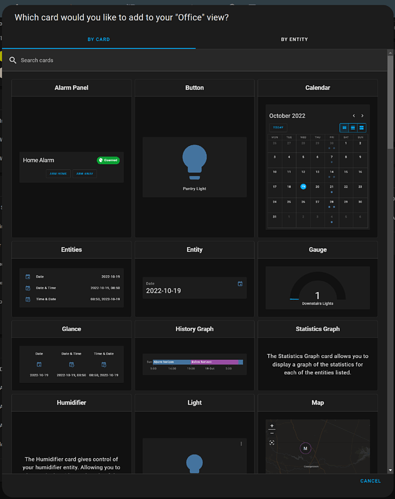

@careingemt Create a card (any card), go to YAML editing mode and replace all of the code with the second code snippet I shared in a previous post. Then edit the entities and labels to match your RGB light. The github page for the cards I used gives all the details on how to configure everything but I am guessing what I already did might just work for you as is. Don’t forget to install the custom cards in HACS before doing this otherwise it won’t work.
Also, you can get rid of the card_mod: and style section as that only formats the card title to a smaller font.
/config/configuration.yaml
right?
No, you have to edit your dashboard but first you must install the custom cards using HACS.
Then install the two cards. Their github pages give all the install and configuration options you need but if you like what I did, all you really need to do is add them using HACS. Search for them under “Frontend”.
Once that is done, you can freely use them in your dashboards… so time to edit one and add a card:
Then:
Then pick any random card:
I picked Alarm Panel Card, but it really doesn’t matter. There is a way to just start with a blank card, but I find this to be faster/easier. Click “Show Code Editor”:
Delete all the code as it is for the other card we do not need:
Now paste in the code I shared above:
To make it work you need to edit the entity names and label:
Hit save and it should work assuming the cards are installed and the entities are typed in correctly… and you copied in all of the code I shared above. I am sharing the same code below with a few changes in hopes it makes it easier for you (so it won’t match the screenshots):
