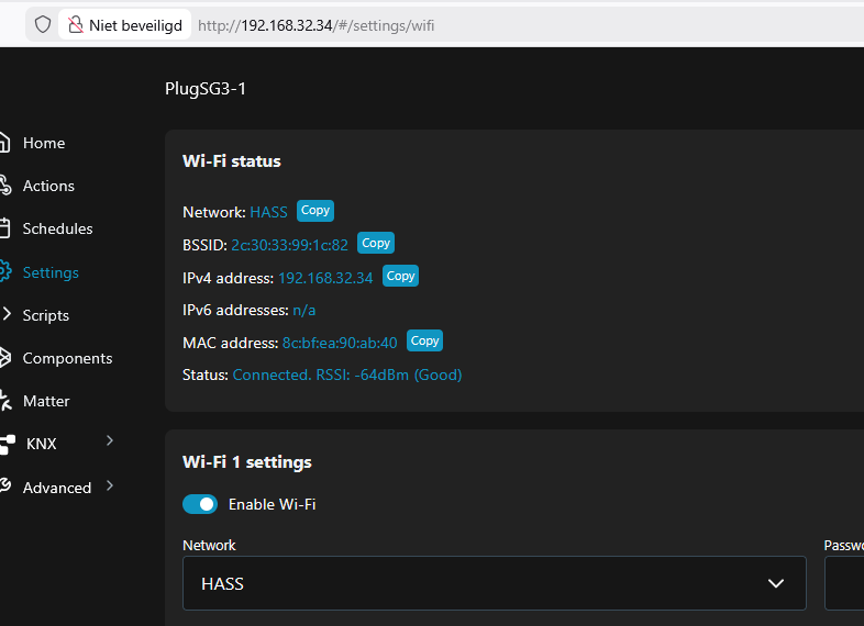

Have you configured it to join your WiFi network?
You can do that through the web UI:
https://shelly.guide/the-webinterface/
Answer to your question: yes, I have configured that

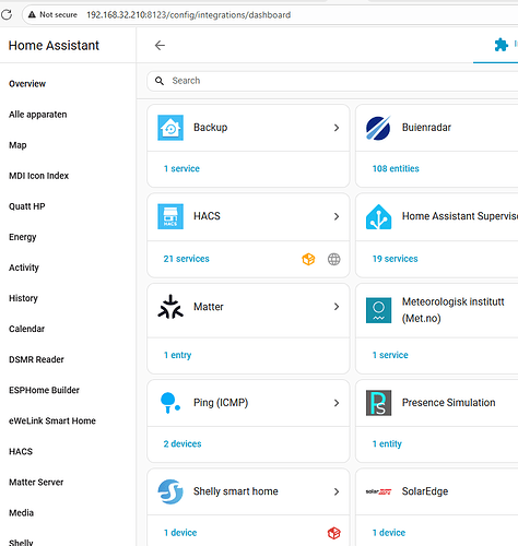

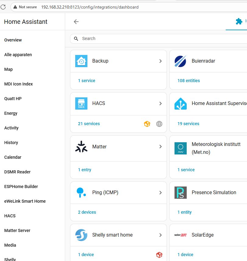

I am not sure what that Shelly smart home custom integration is in your screenshot, but it is overriding the core integration. (That is what the red box means.) That may be why it is not being auto discovered.
You need to uninstall Shelly smart home integration if you want to use the core Shelly integration:
- unconfigure all Shelly devices
- remove
/config/custom_components/shellyfolder - restart HA
- now you should see Shelly devices discovered by the core integration
