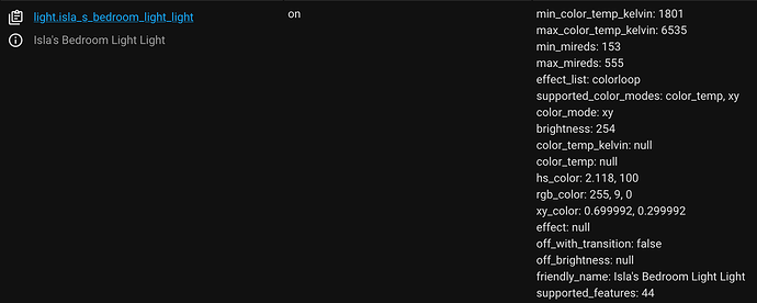

This is the current state of the light according to the developer tools:

I’ve tried using the rgb_color attribute 255, 9, 0 with the same result. I also tried the same with the hs_color attribute with state set to 2.118, 100
I have managed to get a condition to pass by testing the color_mode attribute with state: xy so it seems the condition check can work but I get the impression I’m not giving the state string in the correct form for it to pass.
Sorry if this is a bit of a noob question but I’ve spent a long time trying to find the solution. I’ve wrapped the state string in round, square and curly braces, tried various combinations of spaces, commas, single and double quotes and nothing works!
