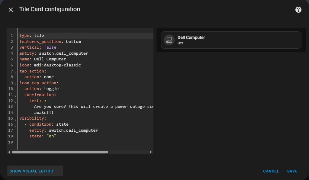

Is it possible only having a confirmation when turning on?
I dont think so, you can programm around that by making 2 buttons, on with and one without and then make a condition to hide the other one depending on the state
There is, what I did was in my view, created a tile for the switch and made its visibility shown only when off for the switch entity. Then edited the view to add another tile card duplicate to the tile card initially created, and set it’s visibility shown when on but then edited it’s yaml for the icon tap action to toggle it with confirmation.
