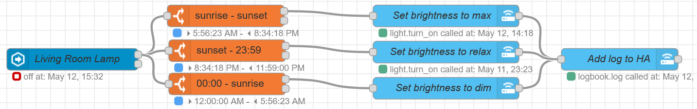

I have a bedroom routine flow that turns off the common area lights using a 10 second transition.
The issue I’m having is that it sets the entity status to off, before the 10 seconds have finished. I have a seperate flow that decides what brightness to set the living room lamp to based on time of day / sun position. This flow is dependent on a state-change node for the living room lamp.
Before the transition flow has finished, the state changes to on and then the light brightens back to full. If i disable the flow that sets the brightness based on time of day, the transition works without issue.
If anyone has any ideas, I’d be super grateful!
This is the flow that sets the brightness, alongside the node that turns off the lamp before bed:
[{"id":"3334dcbf.661ab4","type":"api-call-service","z":"d2b15d3a.380008","name":"Set brightness to max","server":"48b6dc20.3e4a34","version":1,"debugenabled":false,"service_domain":"light","service":"turn_on","entityId":"","data":"{\"entity_id\":\"light.sengled_living_room_lamp\",\"brightness_pct\":\"100\"}","dataType":"json","mergecontext":"","output_location":"","output_location_type":"none","mustacheAltTags":false,"x":622,"y":80,"wires":[["9bded5f8.bd25b8"]]},{"id":"a90478da.c67cc","type":"api-call-service","z":"d2b15d3a.380008","name":"Set brightness to dim","server":"48b6dc20.3e4a34","version":1,"debugenabled":false,"service_domain":"light","service":"turn_on","entityId":"light.sengled_living_room_lamp","data":"{\"brightness_pct\":\"5\"}","dataType":"json","mergecontext":"","output_location":"","output_location_type":"none","mustacheAltTags":false,"x":622,"y":180,"wires":[["9bded5f8.bd25b8"]]},{"id":"e7f25693.472688","type":"api-call-service","z":"d2b15d3a.380008","name":"Set brightness to relax","server":"48b6dc20.3e4a34","version":1,"debugenabled":false,"service_domain":"light","service":"turn_on","entityId":"light.sengled_living_room_lamp","data":"{\"profile\":\"relax\"}","dataType":"json","mergecontext":"","output_location":"","output_location_type":"none","mustacheAltTags":false,"x":622,"y":130,"wires":[["9bded5f8.bd25b8"]]},{"id":"9bded5f8.bd25b8","type":"api-call-service","z":"d2b15d3a.380008","name":"Add log to HA","server":"48b6dc20.3e4a34","version":1,"debugenabled":false,"service_domain":"logbook","service":"log","entityId":"","data":"{\"name\":\"Living room lamp brightness automation\",\"message\":\"ran successfully\"}","dataType":"json","mergecontext":"","output_location":"","output_location_type":"none","mustacheAltTags":false,"x":860,"y":140,"wires":[[]]},{"id":"a7c45811.e9aac8","type":"within-time-switch","z":"d2b15d3a.380008","name":"","positionConfig":"669a23d3.09980c","startTime":"sunrise","startTimeType":"pdsTime","startOffset":0,"startOffsetType":"none","startOffsetMultiplier":60000,"endTime":"sunset","endTimeType":"pdsTime","endOffset":0,"endOffsetType":"none","endOffsetMultiplier":60000,"timeDays":"*","timeOnlyOddDays":false,"timeOnlyEvenDays":false,"timeMonths":"*","timedatestart":"","timedateend":"","propertyStart":"","propertyStartType":"none","propertyStartCompare":"true","propertyStartThreshold":"","propertyStartThresholdType":"num","startTimeAlt":"","startTimeAltType":"entered","startOffsetAlt":0,"startOffsetAltType":"none","startOffsetAltMultiplier":60000,"propertyEnd":"","propertyEndType":"none","propertyEndCompare":"true","propertyEndThreshold":"","propertyEndThresholdType":"num","endTimeAlt":"","endTimeAltType":"entered","endOffsetAlt":0,"endOffsetAltType":"none","endOffsetAltMultiplier":60000,"tsCompare":"0","lastMsgOnStartOut":false,"lastMsgOnEndOut":false,"x":320,"y":80,"wires":[["3334dcbf.661ab4"],[]]},{"id":"fa60bab1.28ebc","type":"within-time-switch","z":"d2b15d3a.380008","name":"","positionConfig":"669a23d3.09980c","startTime":"sunset","startTimeType":"pdsTime","startOffset":0,"startOffsetType":"none","startOffsetMultiplier":60000,"endTime":"23:59","endTimeType":"entered","endOffset":0,"endOffsetType":"none","endOffsetMultiplier":60000,"timeDays":"*","timeOnlyOddDays":false,"timeOnlyEvenDays":false,"timeMonths":"*","timedatestart":"","timedateend":"","propertyStart":"","propertyStartType":"none","propertyStartCompare":"true","propertyStartThreshold":"","propertyStartThresholdType":"num","startTimeAlt":"","startTimeAltType":"entered","startOffsetAlt":0,"startOffsetAltType":"none","startOffsetAltMultiplier":60000,"propertyEnd":"","propertyEndType":"none","propertyEndCompare":"true","propertyEndThreshold":"","propertyEndThresholdType":"num","endTimeAlt":"","endTimeAltType":"entered","endOffsetAlt":0,"endOffsetAltType":"none","endOffsetAltMultiplier":60000,"tsCompare":"0","lastMsgOnStartOut":false,"lastMsgOnEndOut":false,"x":322,"y":128,"wires":[["e7f25693.472688"],[]]},{"id":"38d102f0.28d0de","type":"within-time-switch","z":"d2b15d3a.380008","name":"","positionConfig":"669a23d3.09980c","startTime":"00:00","startTimeType":"entered","startOffset":0,"startOffsetType":"none","startOffsetMultiplier":60000,"endTime":"sunrise","endTimeType":"pdsTime","endOffset":0,"endOffsetType":"none","endOffsetMultiplier":60000,"timeDays":"*","timeOnlyOddDays":false,"timeOnlyEvenDays":false,"timeMonths":"*","timedatestart":"","timedateend":"","propertyStart":"","propertyStartType":"none","propertyStartCompare":"true","propertyStartThreshold":"","propertyStartThresholdType":"num","startTimeAlt":"","startTimeAltType":"entered","startOffsetAlt":0,"startOffsetAltType":"none","startOffsetAltMultiplier":60000,"propertyEnd":"","propertyEndType":"none","propertyEndCompare":"true","propertyEndThreshold":"","propertyEndThresholdType":"num","endTimeAlt":"","endTimeAltType":"entered","endOffsetAlt":0,"endOffsetAltType":"none","endOffsetAltMultiplier":60000,"tsCompare":"0","lastMsgOnStartOut":false,"lastMsgOnEndOut":false,"x":322,"y":174,"wires":[["a90478da.c67cc"],[]]},{"id":"31d99fb1.dff7b8","type":"api-call-service","z":"d2b15d3a.380008","name":"Turn off common area lights","server":"48b6dc20.3e4a34","version":1,"debugenabled":false,"service_domain":"light","service":"turn_off","entityId":"light.common_area_lights","data":"{\"transition\":10}","dataType":"json","mergecontext":"","output_location":"","output_location_type":"none","mustacheAltTags":false,"x":1280,"y":140,"wires":[[]]},{"id":"bfb1dff1.738dd","type":"server-state-changed","z":"d2b15d3a.380008","name":"Living Room Lamp","server":"48b6dc20.3e4a34","version":1,"exposeToHomeAssistant":false,"haConfig":[{"property":"name","value":""},{"property":"icon","value":""}],"entityidfilter":"light.sengled_living_room_lamp","entityidfiltertype":"exact","outputinitially":false,"state_type":"str","haltifstate":"on","halt_if_type":"str","halt_if_compare":"is","outputs":2,"output_only_on_state_change":true,"x":110,"y":140,"wires":[["a7c45811.e9aac8","fa60bab1.28ebc","38d102f0.28d0de"],[]]},{"id":"48b6dc20.3e4a34","type":"server","z":"","name":"Home Assistant","legacy":false,"addon":false,"rejectUnauthorizedCerts":true,"ha_boolean":"y|yes|true|on|home|open","connectionDelay":true,"cacheJson":true},{"id":"669a23d3.09980c","type":"position-config","z":"","name":"Toronto","isValide":"true","longitude":"0","latitude":"0","angleType":"deg","timeZoneOffset":"99","timeZoneDST":"0","stateTimeFormat":"3","stateDateFormat":"12"}]
