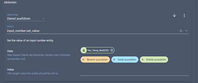

After Updateing to newest HassOS my existing heating Automations seems to work, but if have look into the Config all the input.numbers (variable settings if i open and close a window for example grabed from Climate-Temperature Attribute) are gone - even in yaml mode…
How can this work at the moment if there is obviously no Syntax to write into variable and how do i configure input.numbers if i can`t set Syntax into the Value-Field of input_number.set_value? (only digits and “e” seems to be allowed)

Okay, now i cant set any Value into the Fields. Error Message: Message malformed: Integration * not found

I´ve Just checked the Automation in YAML-Mode again ,
the entrys ‘{{ state_attr(“climate.req1164728”, “temperature”) }}’ are not visible there.
If i check the automation.yaml directly evereything is correct.
This Config is up and running, even after several reboots.
But i also saw that HA has automaticly changed some Syntax in the UI and added a “target” to the Climate-Set-Command
That seems a bit inconsistent for me. Anybody got an idea how to fix this in the right way?
