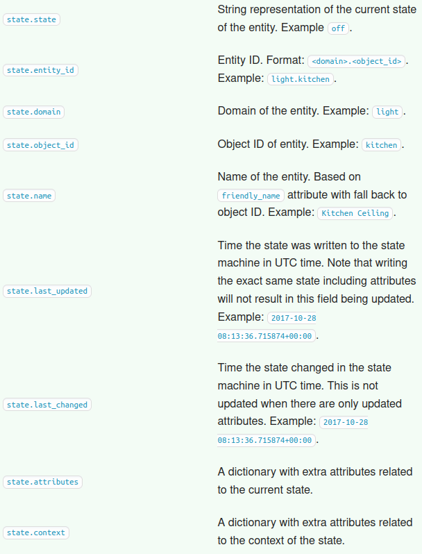

Look at the list of properties in a State Object. Note that one of those properties is name.
That’s what the template is extracting when you use map(attribute='name'). It’s getting the value of the name property from each supplied State Object.
You’ll notice that there’s another property in a State Object called attributes. The value of attributes is a dictionary containing one or more instances of what everyone commonly calls “an attribute” (which serves to make everything even more confusing because that word is being used so many different ways).
So if you want map to get the value of one of the keys that are in the attributes dictionary, such as color_mode, you would use map(attribute='attributes.color_mode')
