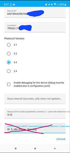

ADDIN THE VACUUM TO LOCALTUYA INTEGRATION
Configuration → Add a new device →
Manual DPS to add: 3,13

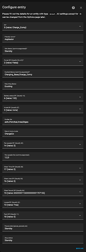

DPS TO CONFIGURE (case sensitive)
  • ID: 5
  • Idle Status: Standby
  • Power: 2
  • Docked Status: Charging_Base,Charge_Comp
  • Returning Stat: Docking
  • Battery: 6
  • Mode: 3
  • Modes list: auto,Punctual,Area,Edges
  • Return home: ChargeGo
  • Fan Speed: 14
  • Fan Speed List: 1,2,3
  • Clean Time: 17
  • Clean Area: 16
  • Clean Record: 15
  • Locate: 13
  • Fault DP: 18
  • Pause State: Standby
  • Stop Status: Standby
Fill all the entries, click SEND, and VERY IMPORTANT, in the next screen UNCHECK “Do not add more entities”

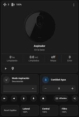

CARD WITH ALL THE OPTIONS FOR THE VACUUM
Needed:
Mushroom card: GitHub - piitaya/lovelace-mushroom: Mushroom Cards - Build a beautiful dashboard easily 🍄
Vacuum card: GitHub - denysdovhan/vacuum-card: Vacuum cleaner card for Home Assistant Lovelace UI
Layout card: GitHub - thomasloven/lovelace-layout-card: 🔹 Get more control over the placement of lovelace cards.
Check vacuum card documentation on how to change vacuum image.
Or just change line 6:
image: /local/images/vacuum_picture.png
Click to show code
type: custom:layout-card
layout_type: custom:horizontal-layout
cards:
  - type: custom:vacuum-card
    entity: vacuum.aspirador
    image: default
    compact_view: false

Hi.
When you add the device is when you have to add the extra DPS, comma separated.
Feel free to ask.
Cualquier cosa pregunta.
Buenas. Si, hasta aquí bien. Los dps van aquí o en la ventana siguiente a esta? Yo lo hice es la siguiente.
Mi Telegram es mi nickname, allí lo dejo xD.
Muchas gracias de nuevo.
A ver si esta noche puedo subir alguna captura
Mejor en inglés así llega a mas gente.
You have to add the extra DPS in the screenshot of the prevoius post, then set the DPS as the next image:
Once finished click on SEND (“Enviar” in the screenshot).
In the next window UNSELECT “Do not add more entities”
imagen
And then add the extra DPs that you couldn’t add in the previous window. As DP 111 wich is “Do Not Disturb”
imagen
Then Send again, uncheck “Do not add more entities” and add the remaining DPs.
Sorry for my clumsiness. I have the feeling that I am stuck in some nonsense, but I still don’t understand where to put the DPS
Here?
I guess I shouldn’t put anything here, and do it in the next window.
You just added the DPS correctly, but you must leave blank “DPIDs to send in RESET…”
Then click on “ENVIAR” and select “vacuum”.
imagen
Click “ENVIAR” again and you will see the following screen:
You have to select every DPS in here. Be careful with the words, all are case sensitive, and some are mispelled.

Do the manual controls work for you? (front, back, right, left)
What component did you put the arrows with?
Thank you
