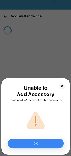

I am a little bit struggling with the setup. I am using the same config as @ha-apprentice and when i want to send the credentials to the phone the phone tells me there are no credentials. And there i am stuck because the pairing always now tells me i the device i want to pair needs a thread border router.
Maybe anyone has an idea?
I am having the same issue; so I would be interested too; If I figure something out, I will come back and tell

Really good instructions, despite these I wasn’t able to connect any devices to the setup. It turns out that I needed to go to companion app Troubleshooting section to sync Thread credentails as per this message:
After that action I was able to connect the Matter device to the HA.
