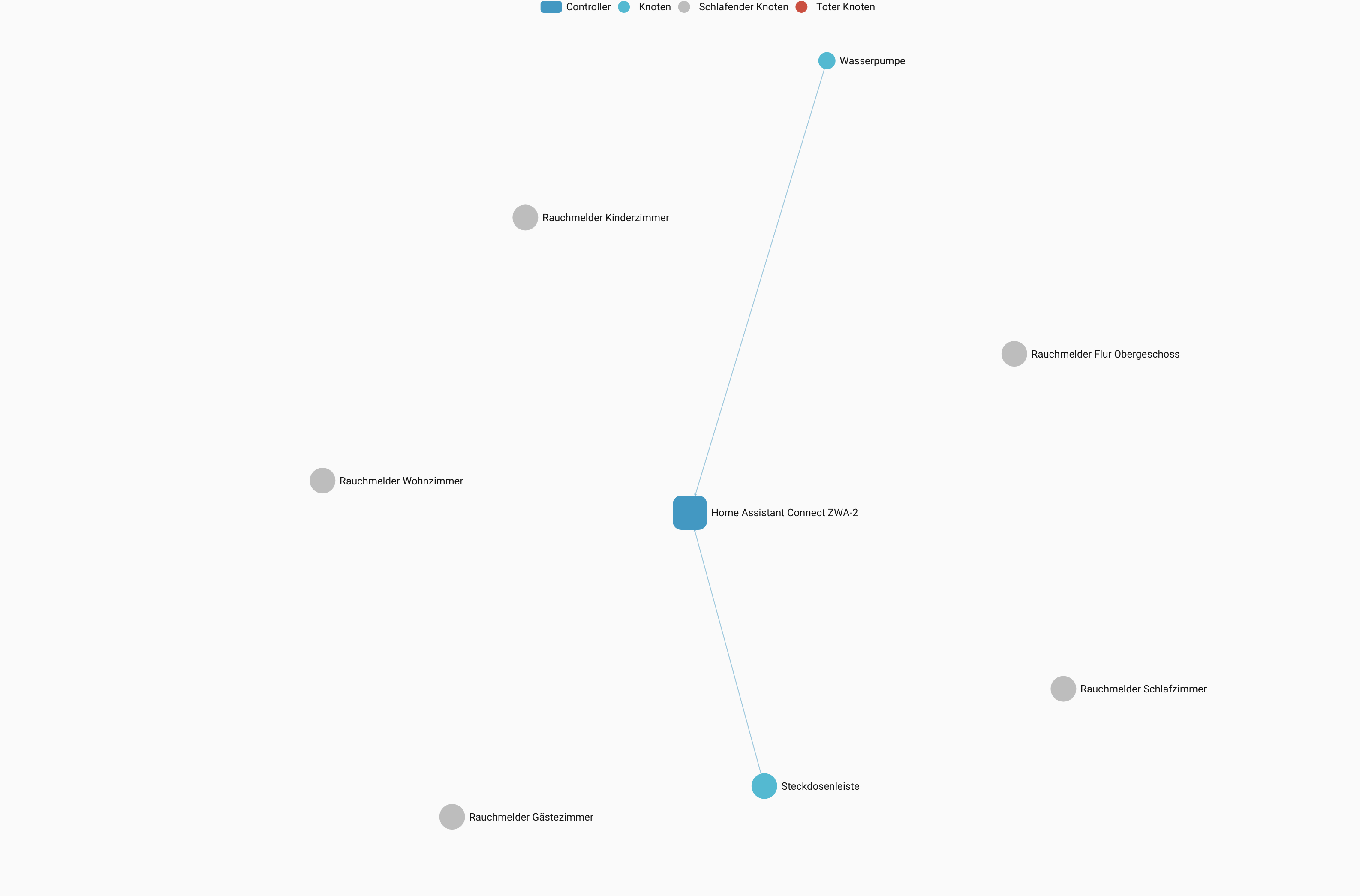

Just migrated mine to the POE variant and it works like a charm. Now also the water pump in the garden has connection :slight_smile: The smoke detectors are sleeping :slight_smile: The water pump is a long range device. The others not.

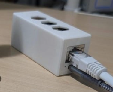

didnt see anyone ask/talk about the POE board that is shown in the pic above
now that would be acceptable, but checking the looks of the Waveshare
I cant imagine that to be a great solution in the user space…
can we order the thing with the case somewhere ?

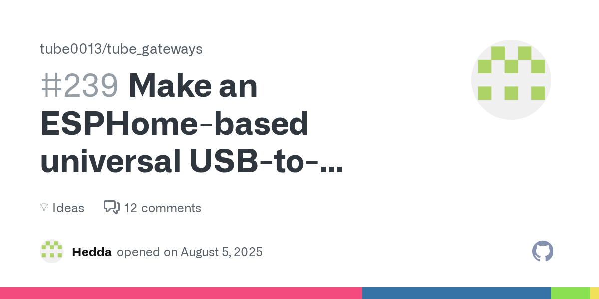

For reference, there is a related feature request / ideas discussion here → Make an ESPHome-based universal USB-to-Ethernet Bridge, a USB to Serial-over-IP (Serial-over-LAN) proxy appliance compatible with standard Z-Wave Controller and Zigbee Coordinator USB adapters Ā· tube0013/tube_gateways Ā· Discussion #239 Ā· GitHub
Or a ā€œPoE docking baseā€ for the antennas… where the base and the antennas would stack or even fit like legos. Then it suddenly would be able to accommodate both the Zigbee and Z-wave antennas also from Nabu Casa :slight_smile:
Yes it is the idea of having such compatible networked USB-hubs bridge concept for remotley connecting to USB IoT radio adapters and other USB serial adapters that this suggestion discussion here is about → Make an ESPHome-based universal USB-to-Ethernet Bridge, a USB to Serial-over-IP (Serial-over-LAN) proxy appliance compatible with standard Z-Wave Controller and Zigbee Coordinator USB adapters Ā· tube0013/tube_gateways Ā· Discussion #239 Ā· GitHub
Would be awesome if Nabu Casa or someone else made a finished product anyone could buy that out-of-the-box is an single appliance that offer multi-port networked USB-hub Serial-over-IP bridge that allow users to remotley connect several USB IoT radio adapters. Preferably with optional PoE support.
That is, suggesting a 4-port networked USB-hub that enable universal Serial-over-IP proxy compatbility with popular Zigbee, Z-Wave, and Thread USB radio adapter, and hopefully can also have built-in Bluetooth proxy support for added value.

Looking forward to setting this up this weekend, but wondering where I can get the file to print the case for the POE board? Looks simple enough to print if the file is available. Thanks for putting the effort into this.
https://makerworld.com/en/models/1536469-waveshare-esp32-s3-eth-poe-case-opendtu#profileId-1985828
This link comes from the original article of which was referenced at the very top of this topic.
Very easy to print, two parts I printed had an excellent fit.
