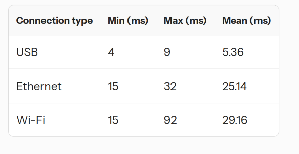

Wi-Fi is very convenient, but the million-dollar question is: how will it impact your Z-Wave network? To find out, we ran some benchmarks to see how Portable Z-Wave stacks up to its USB counterpart.
Compared to a direct serial (USB) connection, a data packet will take longer to travel between Home Assistant/Z-Wave JS and your Z-Wave network when routed through your local network. On a network with only a low to moderate workload, the additional delay is very small and is generally not noticeable. That said, if your network is heavily stressed or the Wi-Fi signal is poor, you should expect packets to take longer to move around, which can lead to a perceivable delay. It can still control your lights and other devices, but it may be a bit slower. Here are some numbers illustrating the typical latency that we were able to achieve across our test environments:
Connection type Min (ms) Max (ms) Mean (ms) USB 4 9 5.36 Ethernet 15 32 25.14 Wi-Fi 15 92 29.16
Your results will likely differ somewhat, especially in less ideal conditions and environments. For instance, if you place your Connect ZWA-2 in a spot with really poor Wi-Fi connectivity, you might notice devices not reflecting their actual state or other buggy behavior. Avoid using VPNs or other complex network routing or configuration, as that will add latency. Also, don’t worry about Wi-Fi interfering with your Z-Wave network, as they operate on totally different radio frequencies that don’t interact. I think with a healthy dose of common sense, you can find a great spot that gets both great Wi-Fi connectivity while nicely optimizing your Z-Wave network.

However, these latency numbers bug me. While 50-ish ms on a poor Wi-Fi network could be understandable, then 15-32ms over Ethernet is completely out of place. On my network, I’m getting ~2ms latency over Wi-Fi (including latency to ESP8266 nodes) and <0.2ms over Ethernet! This means latency in this experimental mode should be about the same as over USB.
I’m betting on some areas to improve in ESP proxy code. Is it possible to use DMA there?

While I do not know exactly how they measured the latency I am assume that it is not simply the latency of the network they measured as guess there are delays in both the respons-time of the Silicon Labs API for Z-Wave running on the Silabs microcontroller SoC and ESPHome’s “Z-Wave Proxy component” with “Protobuf” implementation (ESPHome’s protocol buffers for the Silabs serial communication protocol) that they do in this Serial over LAN (SOL) server with a mechanism for serializing and buffering of serial communication of Serial-over-IP tunneling via ESPHome.
Regardless, keep in mind we are talking about ESPHome running on the ESP32 chip talking over serial/UART to the Silicon Labs MCU that uses the Z-Wave application firmware via its propriatory serial CLI/API. As such there will be additional delays in the full chain. So guess you can not just compare it to how fast you can ping stuff on your networks. Simplified schematic:
Z-Wave JS ↔ LAN ↔ ESPHome + Protobuf on ESP32 ↔ Serial ↔ Z-Wave FW on Silabs MCU.
Anyway, this really is awesome as-is, however I too hope they will continue to improve/optimize performance while not sacrificing reliability as both low-latency and stability are two keys here.
