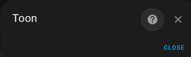

When trying to connect the toon via Engie/Electrabel. I get through to the Engie login page and then the prompt to link account to home assistant (with my local ip filled in).
However when being redirected back to HA I get the following empty message
Anyone has an idea on how to proceed?
