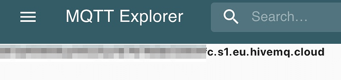

MQTT Explorer connects just fine from my network so I know credentials word.
