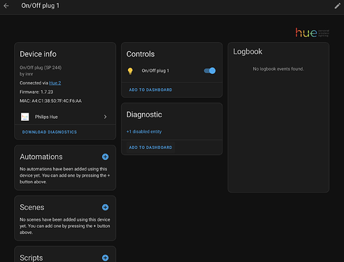

Install it as an on/off switch in Philips Hue, it will only be an on/off switch for whatever plugs into it.
Remove it from the Hue Bridge, then try to install it in HA (Home Assistant). It’s a zigbee device (ZHA), basic Zigbee stick should work to pair it.
You see something this now, for the Hue installed plug:
