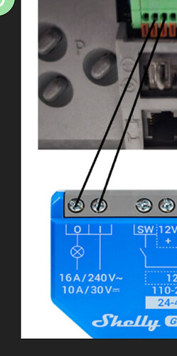

Hi all
I really like to make my garag doors smart in HA.
But im so confused about the wiring part.
First some links
Garage door control – The unofficial Shelly guide!
Shelly 1 Gen4
Facebook
But im getting diffrent wiring discriptions?
and

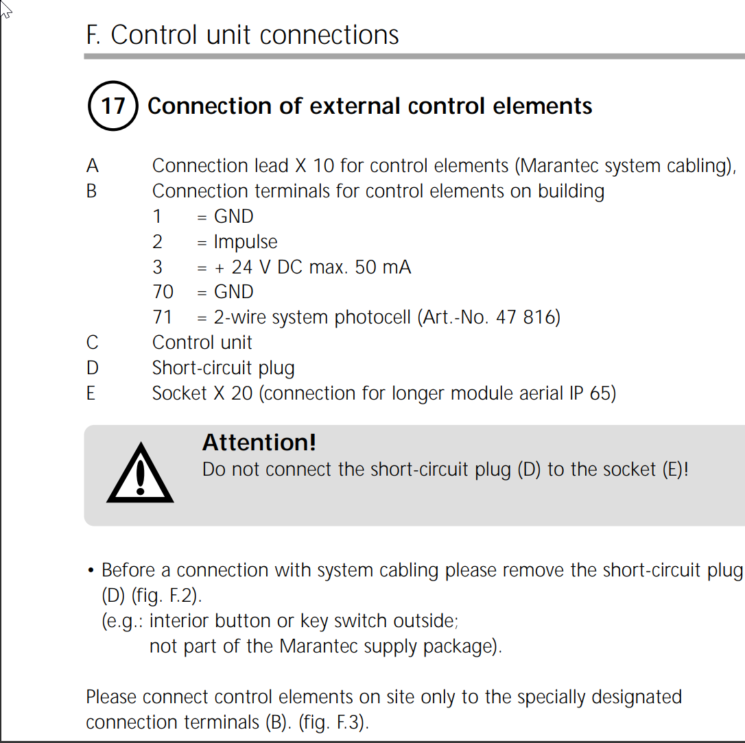

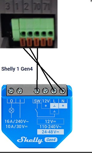

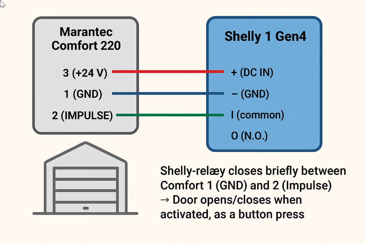

I think i want to power the Shelly from 24v DC from Marantec.
But why does the diagram shows 2 wirings to GND?
Chatgpt has helped me (Sorry it messed with the “æ” )
So now i just cant get my head around where the wires should go?
Can somebodu help? Thanks!

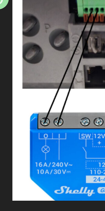

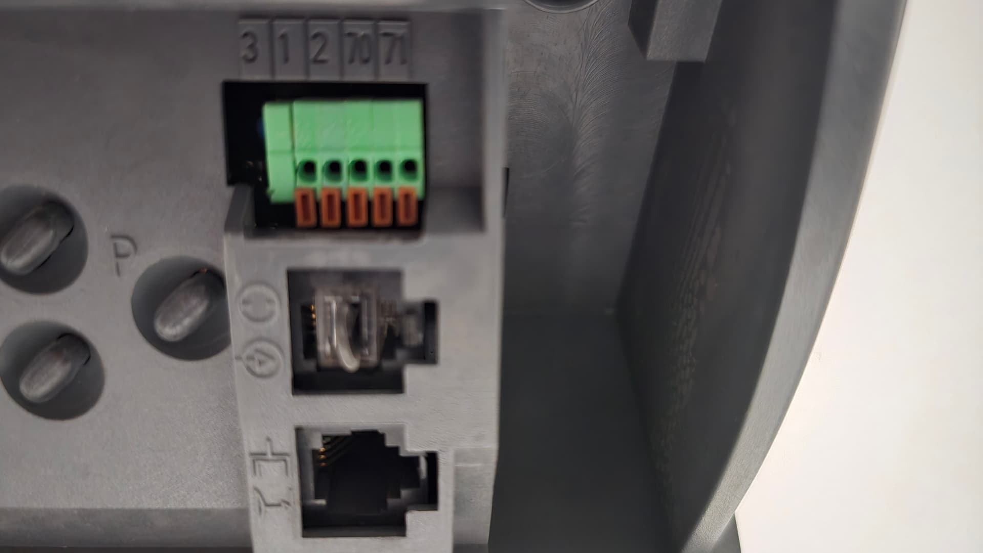

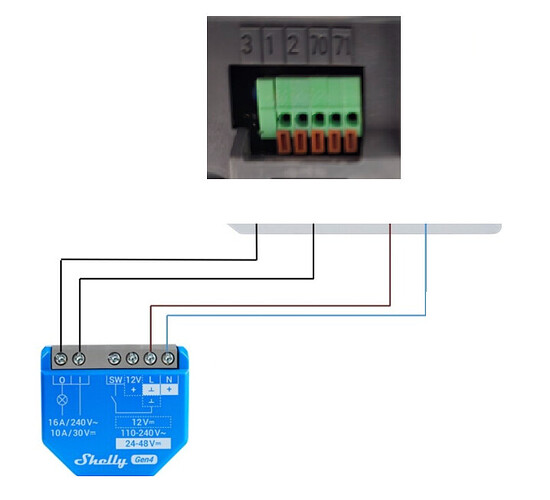

Okay getting closer But now im not sure about the IMPULSE.
My collegue that know meny things about wiring has come to this

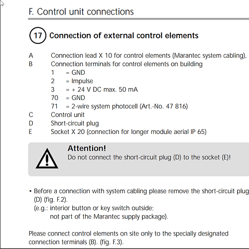

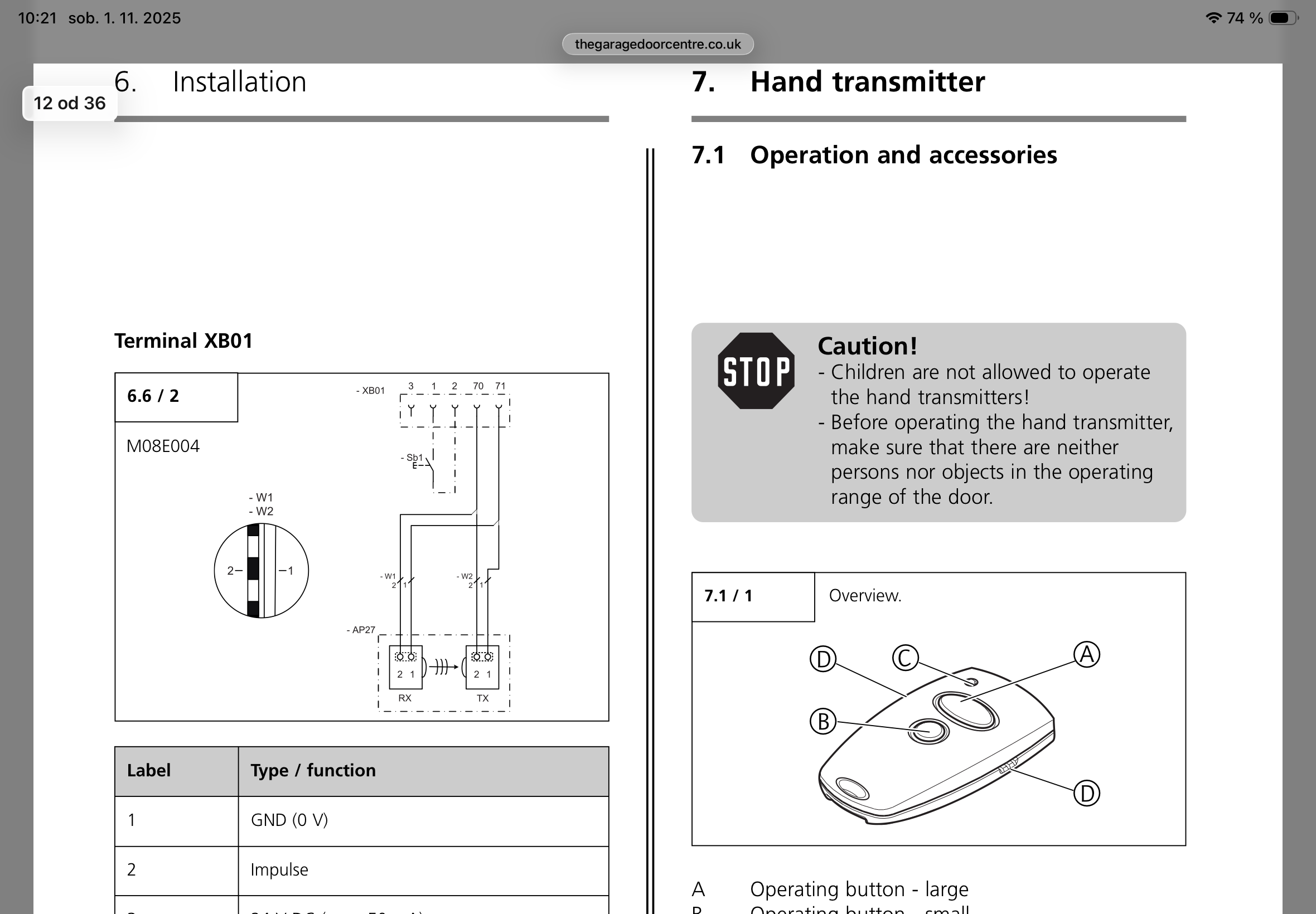

Normally garage doors gets triggered by short connection of GND and “pulse”
Terminal 2 (impulse) should go to shelly O
GND should go to shelly I (jumper from L)
Nothing to shelly SW
You can test it before (without Shelly) just with piece of wire, connect terminal 1 briefly to terminal2 and door should open/close.
1 = GND
3 = +24V
Door movement is by shorting GND and IMPULSE, so 1-2

And be aware that you are very close to the 50mA limit of your 24V supply.
If you have any hiccups, power it from mains.

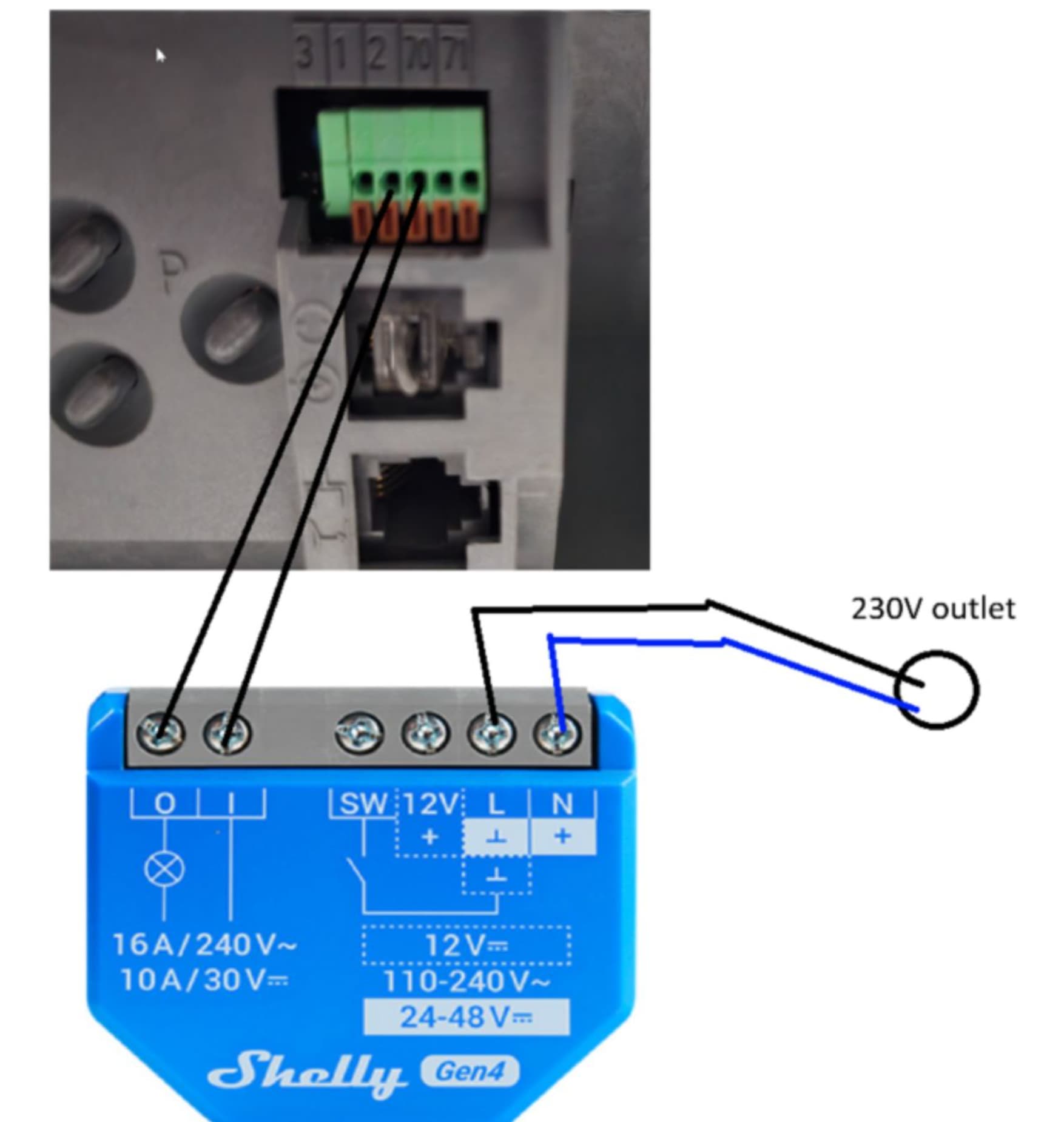

But will this then work?

Hmmm after looking again are we sure? Will it not sendt 230 V into the Marantec? Damn it is confusing
Karosm
(Karosm)
November 3, 2025, 9:28am
11
Shelly 1 has dry contact output. It’s not sending anything, just connecting I to O.
If you feel uncomfortable with mains powered device, stay with 24V.

I think it is better with 230v
But im just confused about there marking about 240v here?
Karosm
(Karosm)
November 3, 2025, 12:31pm
13
It’s the rating of that relay, max 16A / 240VAC or max 10A / 30VDC.

HI Sigvah
It is working perfect!
Just 230V from the same outlet as the Marantec and from the impuls to Shelly.
@Karosm helped me
