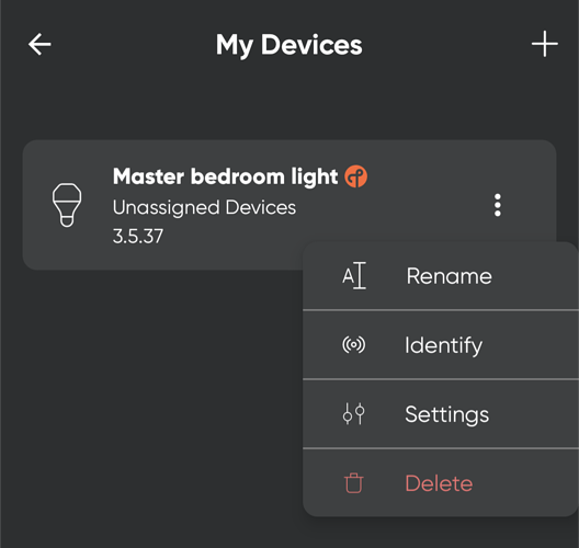

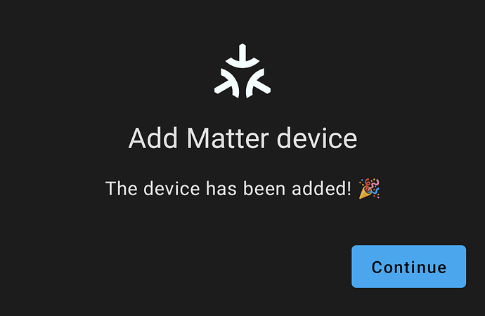

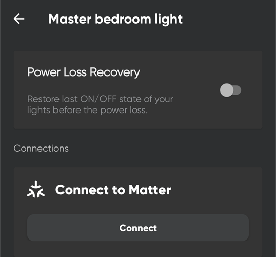

I can add it from the Nanoleaf app to HA Matter (see images below) but still can’t combine the two border routers on the same network (silicon labs multiprotocol with the Google Nest Hub). Hopefully somebody may know how this is possible.

I have finally had success with adding these bulbs to home assistant. I initially failed trying to add them through HA, so I used the Nanoleaf app. I paired them in Nanoleaf, it found my HA Yellow border router and added the bulbs to the network. I was then able use the Nanoleaf app to add the bulbs to a Matter hub, and HA came up as an option.
