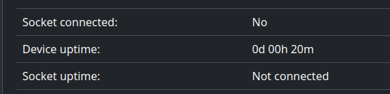

i have similar issues since days… its annoying me so hard i even changed my zigbee-adapter to avoid that one but today it totally crashed again - every device was offline so i restarded zigbee2mqtt but it couldn´t connect to my adapter (again…)
[2025-12-16 10:42:10] error: zh:zstack:znp: Socket error Error: read ECONNRESET
[2025-12-16 10:42:10] error: z2m: Adapter disconnected, stopping

And the strangest thing is im using a SLZB-06P10 but it cant even connect to that
Now I got even bigger crashlog and again I had to restart whole VM.
