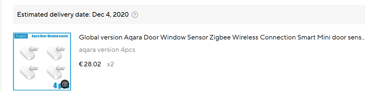

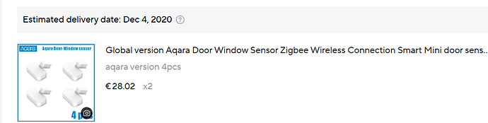

I’ve been running the 11LM via Z2M at the farthest edge of my mesh without a single issue. Only installed one of them at the time since I wanted to see whether they’re reliable, but…
Went to check when I bought them, and it’s been 5 years of rock solid performance and still using the original battery!
