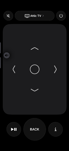

I can control the TV with the HomeKit remote, but the volume buttons aren’t showing up. What could be the reason?
To resolve, thank you.
I wonder whether someone had an issue of not seeing the TV in the remote app, although it is seen in the home app.
Did someone had such an issue and managed to solve it?

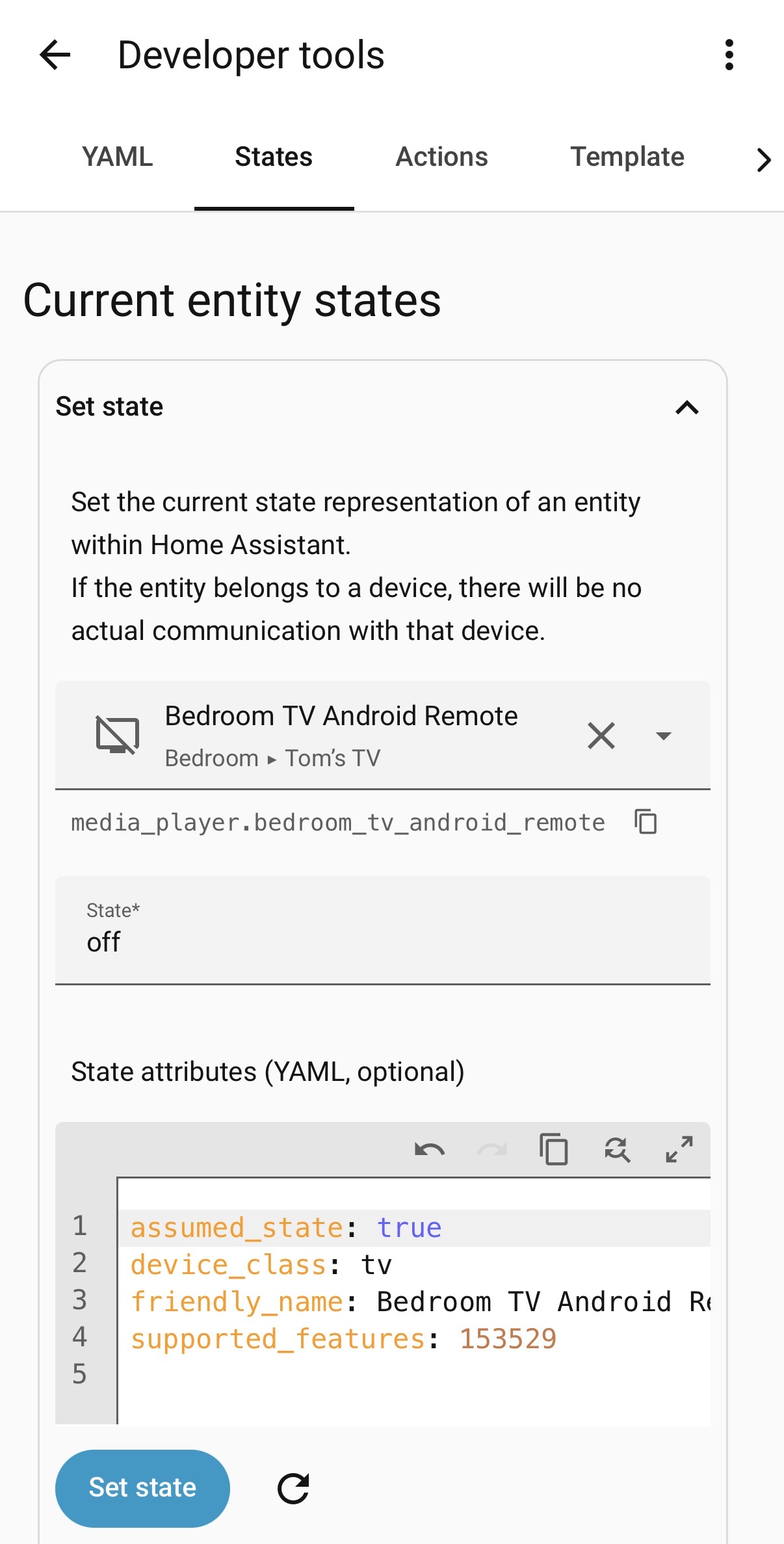

Could you take a screenshot of the entity in the “States” tab in the developer tools?
Sure.
It looks good
Can you try it on another iPhone or iPad?
Unfortunately, the same behavior on all iPhones/iPads I have.
Tried to re-add the android tv integration, create a new accessory bridge (via UI and manually via yaml), there is no change.
