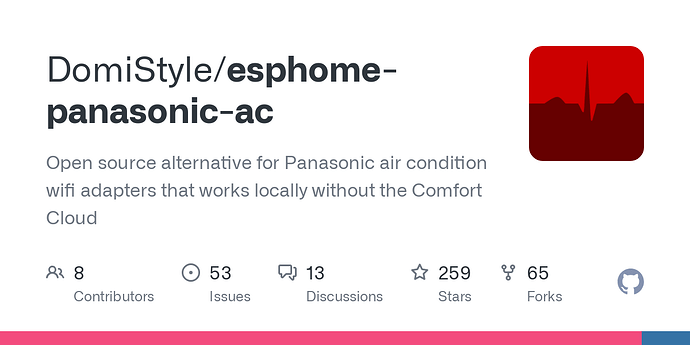

I’d recommend using esp to replace the wifi adapters for daikin & panasonic. Then just group them in ha
You program it with the codes from the remote when its not already there from the available profiles for the devices that you want to control through it, the other option is as ferb stated and use an ESP setup when you don’t have built in wifi modules and options for integrations that support them.
