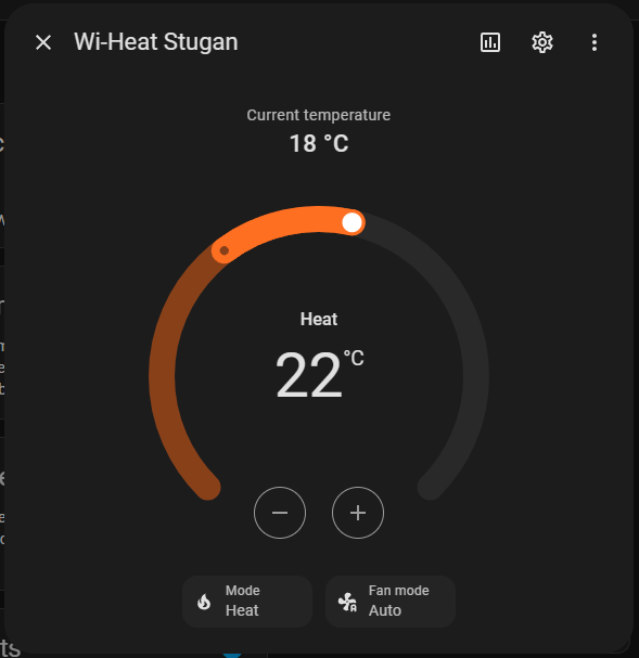

I’ve also been interested in getting wiheat control in Home Assistant. So I have created a custom Home Assistant integration that fetches data from the wiheat API every 60 seconds together with some basic controls.
This is my first Home Assistant integration so there is room for improvement. I still haven’t figured out all of the values in the wiheat API. But I’m able to turn on/off, change temperature, change HVAC mode and change fan speed with this integration.
The integration has been built and tested for a IVT Nordic Inverter 12 PRN.
Feel free to give it a try and see if it works for you.

This is great, any change you could “publish” it to hacs? easier to grab and likely more ppl willing to install it and try it that way :slight_smile:
Thanks! Yes, I have an open pull request for it to be added to HACS but the queue is quite long so it can take a couple of months.
was pretty easy to add as a custom src so no worries.
Now, let’s see if i can create some sane on/off automations based on temp for the wifes flowers… :wink:
