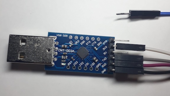

  • A USB to TTL serial converter, such as a CP2104, plus jumpers
    CP2104

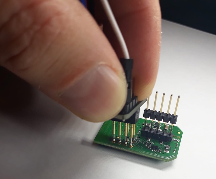

  • 6 x P75-E2 “Spring Test Probe” Pogo Pins
    pogo

Place the pogo pins into the ESP-01 breakout adapter. I had to press rather hard to get them to seat properly. Wire up the USB-TTL converter to the breakout adapter using 3.3v (NOT 5v).
1
2

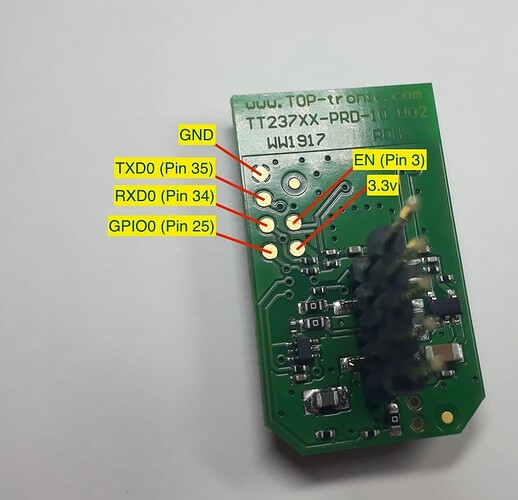

To enter programming mode, the ESP32 on the dongle must have GPIO0 held low (grounded) at power-up. Thus, through each of the following steps (backup, erasure, programming), you’ll need to physically touch GPIO0 (the blue wire in the photos) to ground while plugging in the USB cable. You can remove it right after applying power (i.e. after plugging in the USB cable).

I´ve soldered my USB-TTL-UART-adapter directly to the jura-ESPRESSIF-device: GND, RX, TX, and 3V3 (plus extra GPIO0 for getting device to programming mode) as described. Is it correct that EN (Pin3) is not needed, right?
When I connect it to my mac´s USB-port the UART-adapter is found and ESPRESSIF-device gets powered up as a blue LED begins to flash on the board.
When grounding GPIO0 (just touching does not work, need to connect it to GND) while powering up, the blue LED stays off indicating device is in program-mode - am I right?

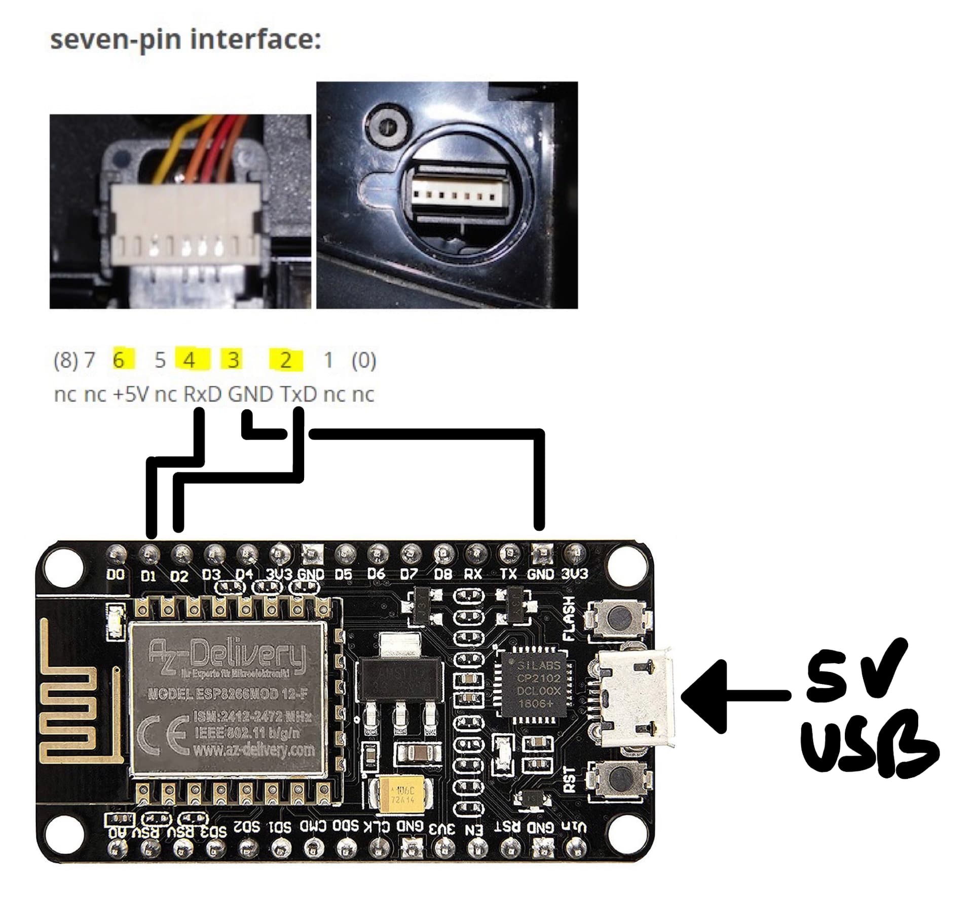

Hello everybody,
I successfully flashed an NODE MCU (ESP8266) with the ESPhome jura component (thank you @ryanalden).
Connected it to the E8 (7-PIN) service-port as follows:
As shown above I provided extra 5V via NODE MCUs micro USB.

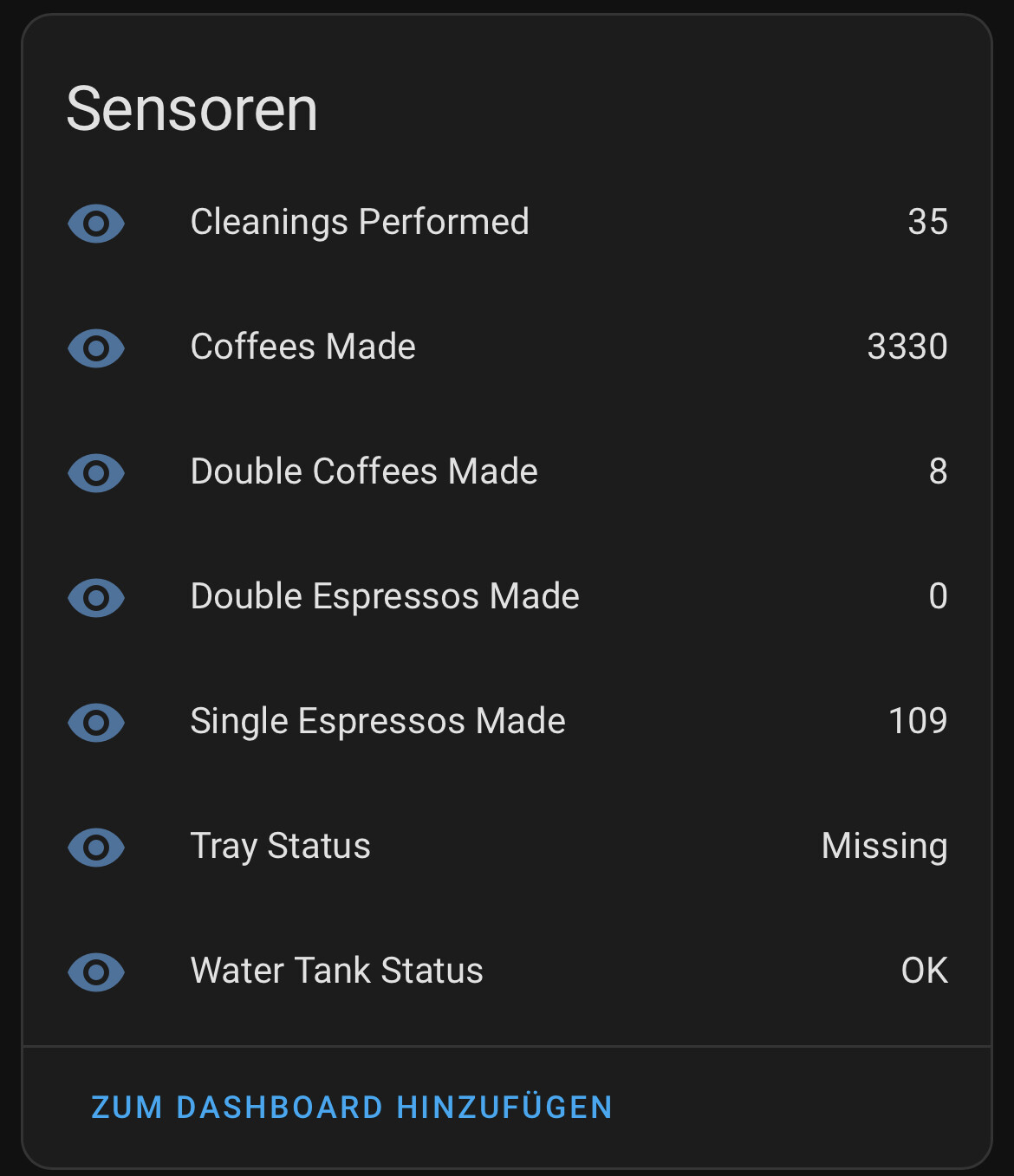

Yipeee!!! :smile: got this results that have been read out correctly:
  • Only the “Missing Tray” does not seem to be correct.
Unfortunately the HA buttons don’t provoke the right actions (except the turn-off button):
  • The button “Make coffee” results in E8 using the lower right button (*).
  • The button “Hot water” results in E8 switching to displays “Maintenance Screen”; this is the lower left button (*).
  • The button “Turn on” stays without effect.
(*) confirming this code page:
I will now proceed trying the different in this forum discovered codes (thank you all!!) to the ESPhome component and post what works! :slight_smile:
