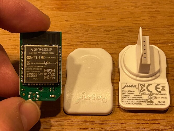

I bought a Jura E6 with a WiFi smart connect plug. I “thought” to have seen the E6 was compatible but was too fast with ordering because it seemed afterwards that only the Bluetooth Smart Connect was compatible. Well, that escalated quickly :sweat_smile:
But I popped open the WiFi Smart Connect and noticed they use a Espressif ESP board. So I took some pictures for other people to see. I would love to help in getting my E6 working on WiFi :slight_smile:
I actually use a Homey but am hoping to get something working through MQTT or whatever works.
Would something work like soldering an usb port to the Espressif and reading data from the unit?

Sorry for the extra post. I couldn’t add 2 photos in 1 post (newbie alert).
