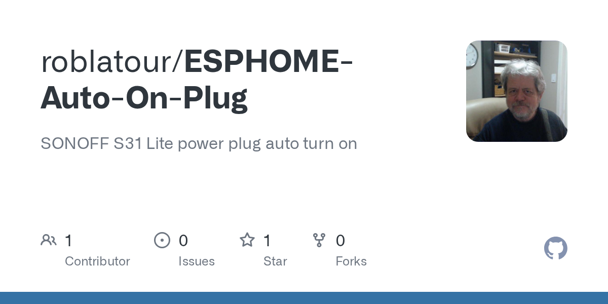

Last year I released an open source solution on Github which showed how to flash a Sonoff S31 power plug on esphome such that the plug when turned off would automatically turn back on after a short delay.
The purpose of such a solution is to recycle the power to a device that needed to be hard rebooted (power off power on) remotely.
Recently, however I came across an issue that I couldn’t turn off the switch via Home Assistant (as was my normal use case) as the network connection to Home Assistant wasn’t available.
Accordingly, I’ve now added a python script that allows me to directly turn off the plug remotely from my computer (Windows machine but could be Linux as well) without needing access to Home Assistant.
If this sounds as if it could be helpful to you, here’s the Github page for it:
