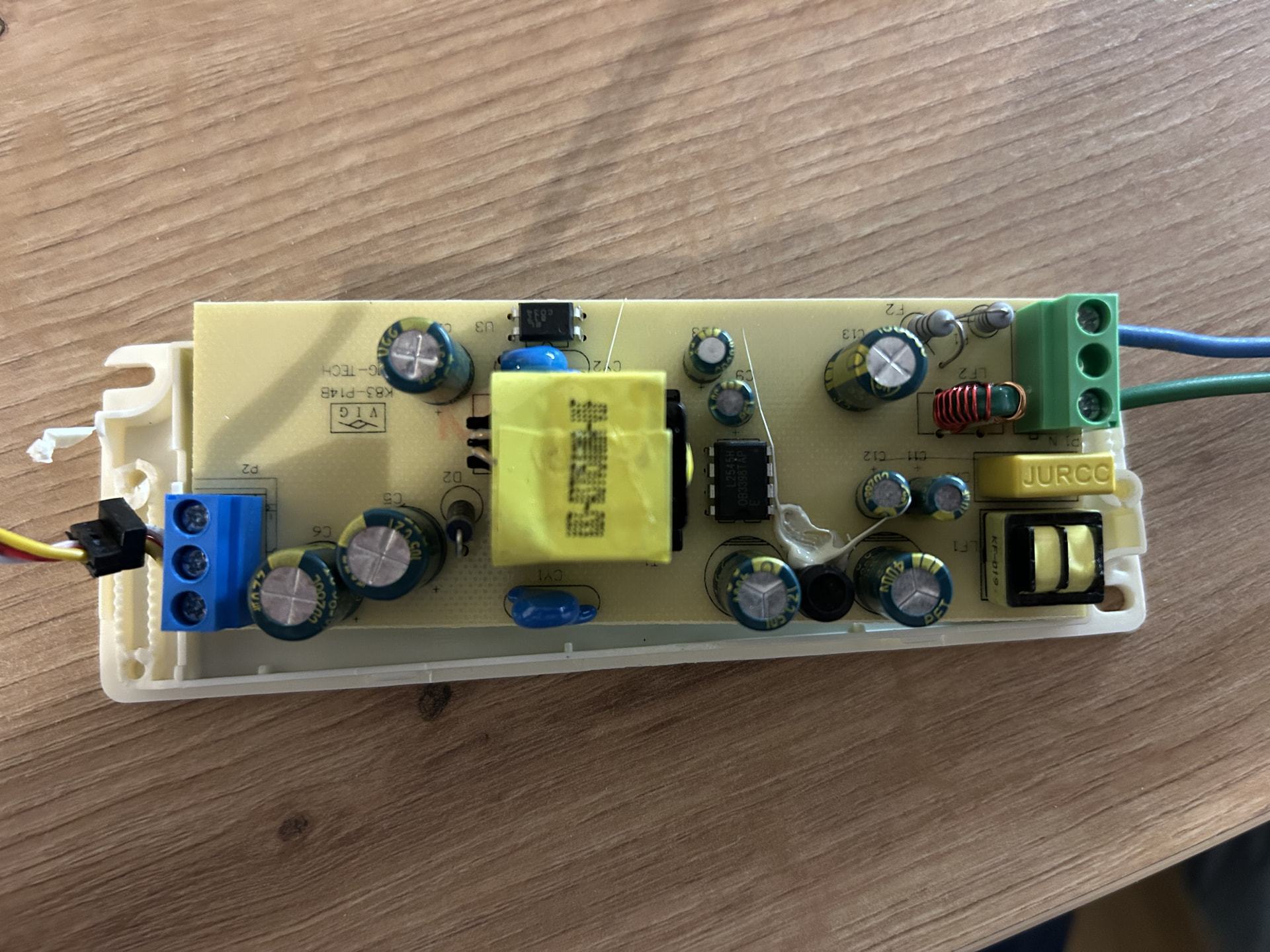

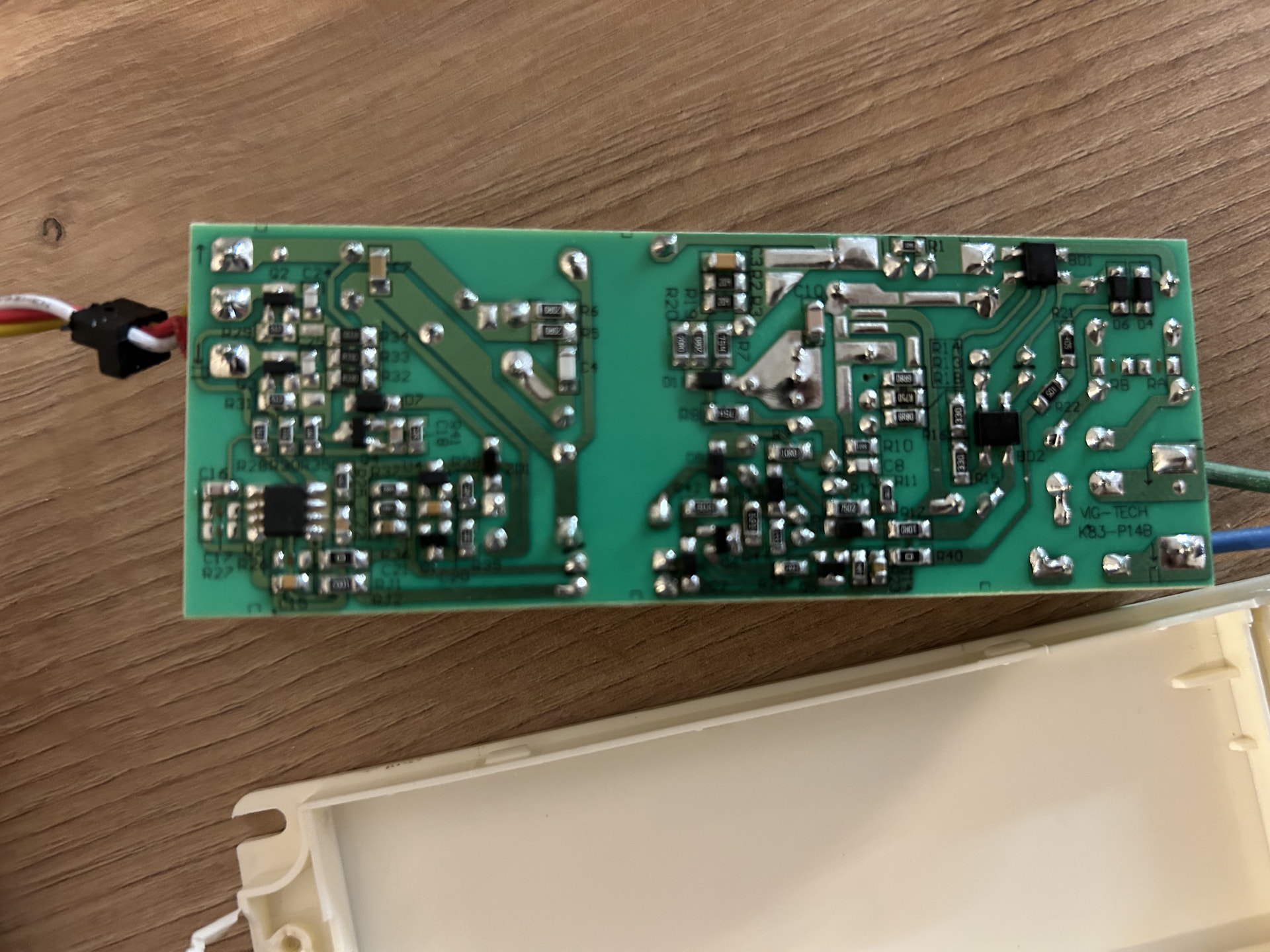

The PCB is marked VIG-TECH K83-P14B and the only IC with more than 4 legs that has not been etched identifies as L2545H. Does anyone have experience controlling these or similar drivers via Homeassistant / ESPHome or anything?

Anyway, can you find antenna circuit on that PCB?

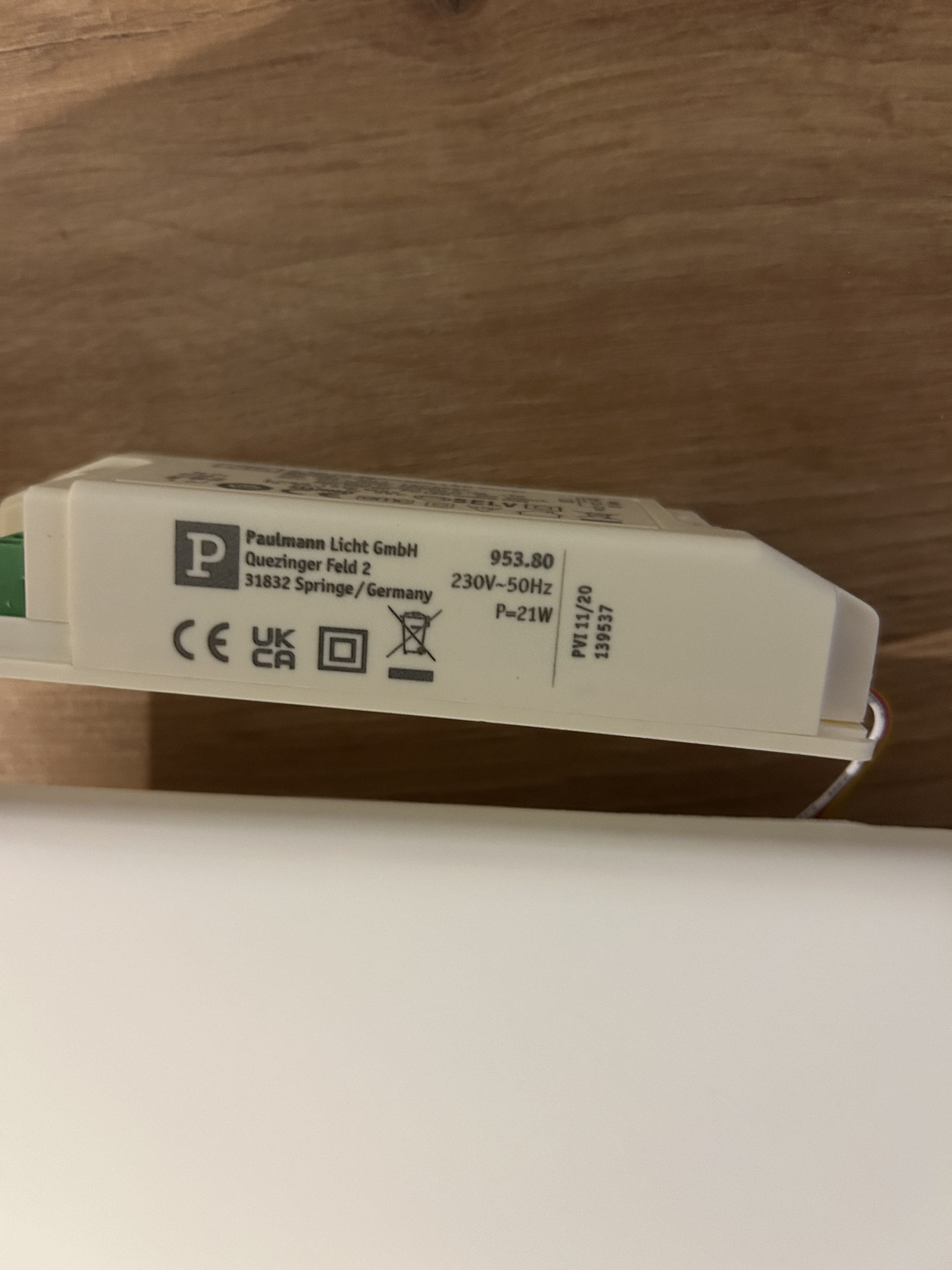

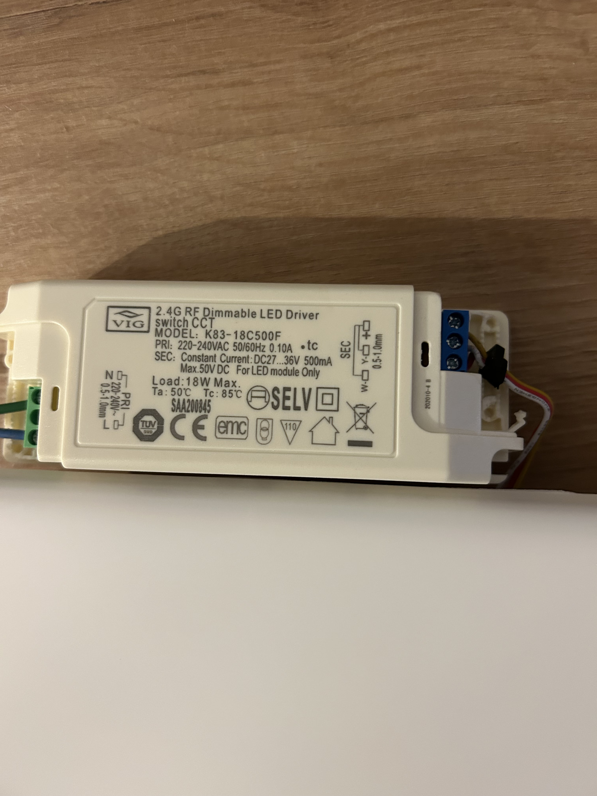

Sadly they do exactly that - mine:

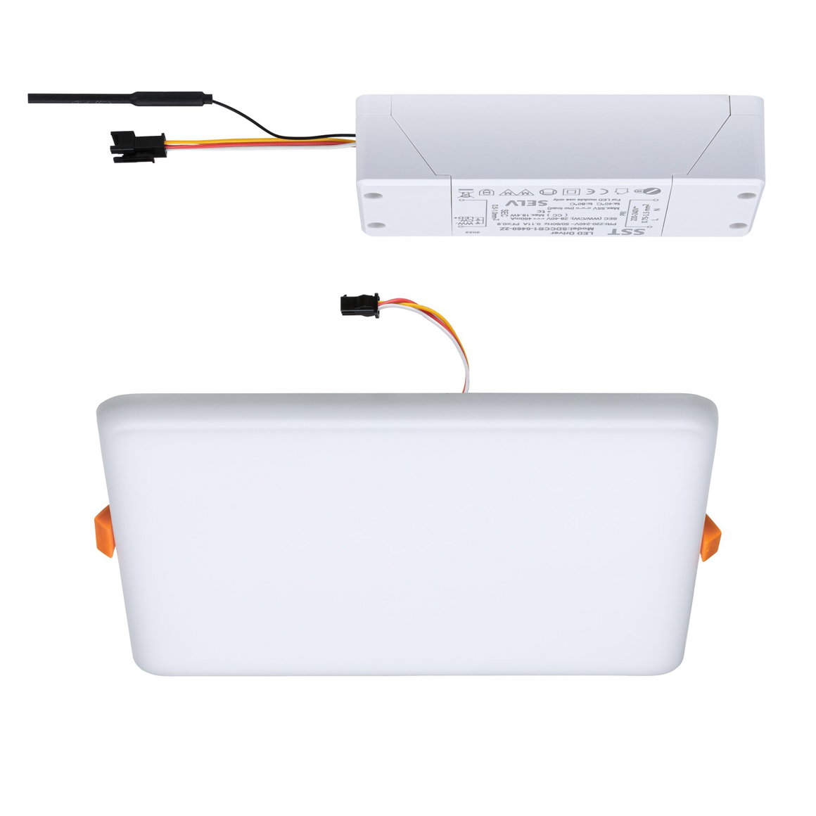

The tunable white version (with Zigbee):
I don’t see any obvious antenna - neither a pigtail nor a trace in antenna shape on the PCB
I would trash the controller and experiment with building my own controller. If it is a constant-current driver with a relatively narrow voltage range I would suspect the brightness is controlled with a PWM-like driver. Colors, however is so far a mystery. Do you mean RGB range of colors or warm/cool? I would be curious to determine if there is any electronics in the LED housing.
Neither did I, that’s why I asked. Examine well or send good photo. Antenna can be trace or chip.

Did you find any “antenna kind of circuit”?
