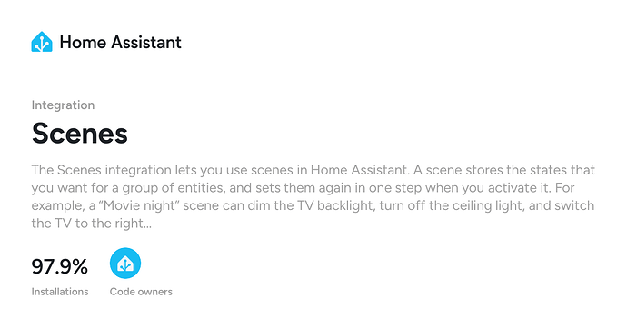

Use a scene. If you always want them to be the same value. Then another scene if you want to set them all to different values, this is the simplest way.
Thanks for responding!
Will this method allow me to have a control on a dashboard that I can set?
Not if you want to change the values. But to have a number of scenes with set values is easy.

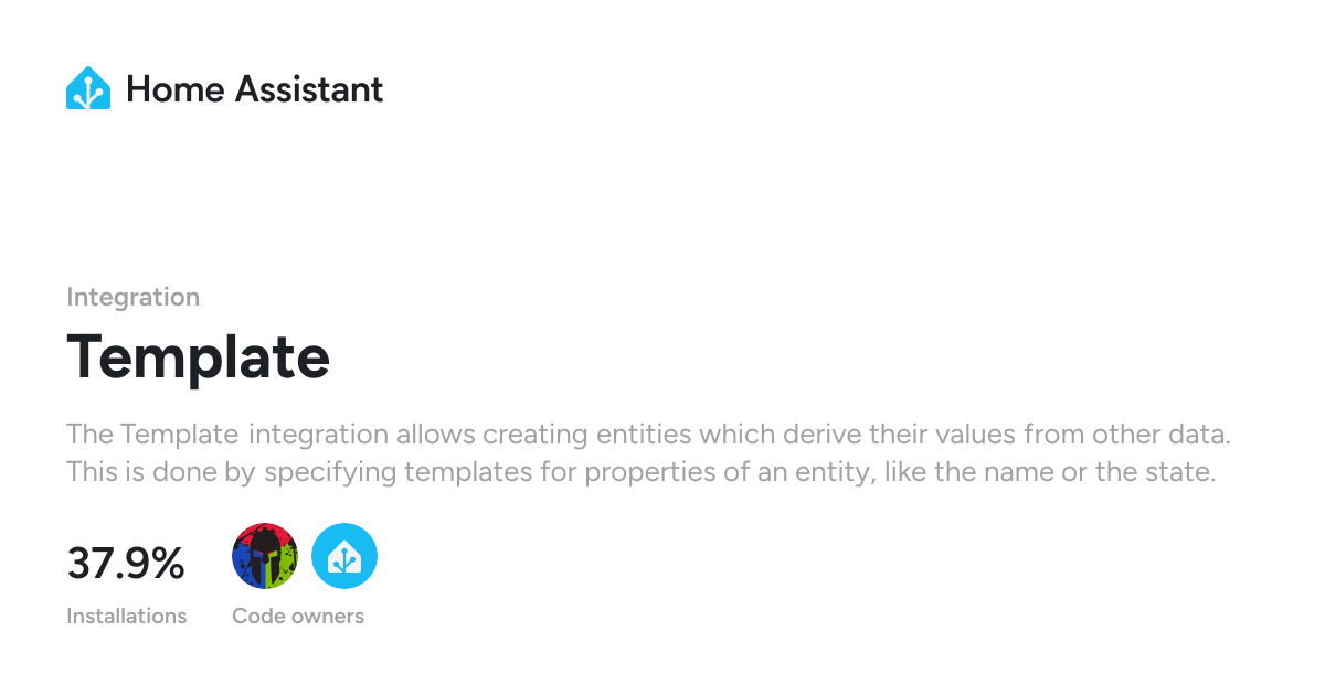

What you’re asking for is a template number.
Template - Home Assistant
Make the action part set all of your other ents
(Scene is also OK but doesn’t give op the live control they want)

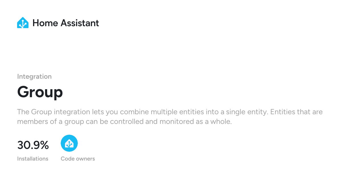

Are the four items showing up as lights/bulbs in Home Assistant at the moment?
If they are, you probably just want to create a light group.
That basically allows you to control the brightness, color temp on/off of all the bulbs as a single entity.
If they are not lights/bulbs and are in fact simply numeric entities (per your post title) then you will have to use one of the other answers here.

Is there any reason that a number group wouldn’t work?
I was sanity checking, because it’s not uncommon for posts to be X-Y problems.
