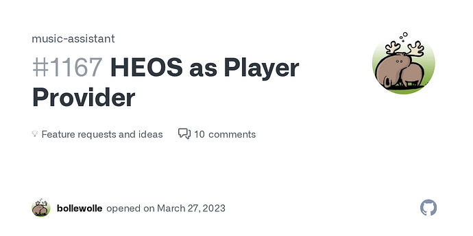

Have you tried the denon HEOS integration? Or only the denon network AVR receivers integration?
Edit: I see HEOS is added a few hours ago for 2.8.0 beta 8:
No i haven’t yet. i will try that tonight. thanx!
i tried to add HEOS integration, it asks for an ip-address while adding. i entered the ipaddress of my Denon AVR-X2300W but returned an error it could not connect. i doublechecked the ip it’s correct (web interface works)
it turns out that Denon AVR-X2300W does not have HEOS compatibility
