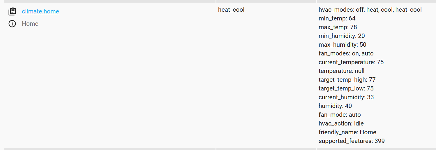

I have an ecobee (see dev tools screenshot:
and in node-red all I can add is
climate.home which doesn’t seem to give me the info of the “hvac_action” which appears to tell me if the system is “cooling” or “heating” or “idle”

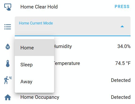

nor “friendly_name” which appears to tell me which “mode” (ecobee templates) Home, Sleep, Away (etc, or custom)
i can only see the “hvac_mode” attribute, which tells me if the system is off, or set to cool,heat, auto in the traditional sense of thermostats

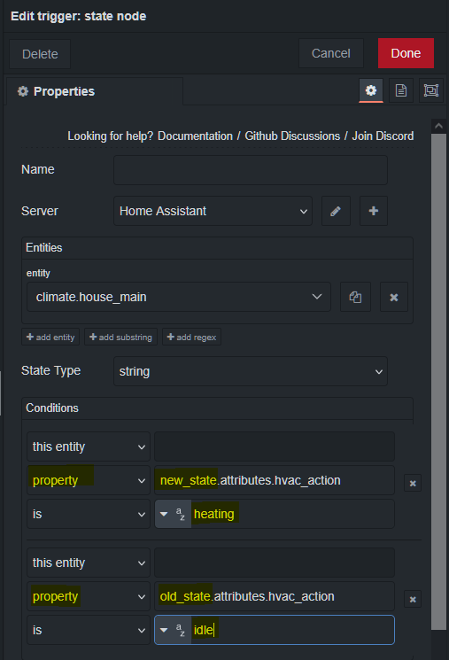

The easiest way to use attributes to trigger is to use the trigger state node. The setting below will trigger when going from idle to heating. Notice it is set to property and the old and new state.

but so in your example, it’s only going to “work” or detect a change if it was in the “idle” state and changes to “heating” as an example, but then so i’d have to have one of those for each state to trigger unique actions? I’d rather have it send the state to a switch and then trigger different actions.
Is there documentation somewhere that you know of to find that talks about the “new_state.attributes.x” and “old_state.attributes.x” that you used?

for example, i make two Home modes on my thermostat with different target temp ranges, Home1 & Home2
then make a switch node where
if wife is home → attribute “friendly_name” : Home1
if wife is not home → attribute “friendly_name” : Home2
or using the attributes you used in your example, is it possible to ‘use node-red as my thermostat’ so to speak and actually set a temp range to tell it to call for cooling and toggle the hvac_action to cooling with my own conditions?

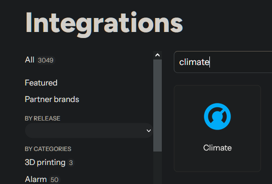

The first word in an entity is it’s domain. In an example climate.xyz it’s domain is climate. You can enter a domain in the integrations page of the documentation. You will find a link to it’s documentation and available actions.

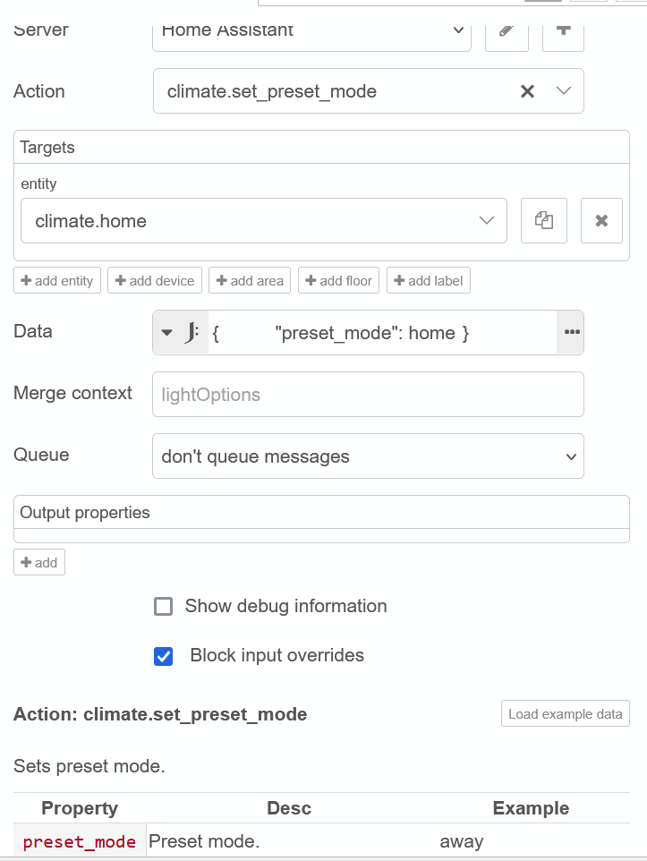

I assume home1 and home2 would be presets, so you could use the action climate.set_preset_mode. So in short, you can change attributes but they will have their own action.

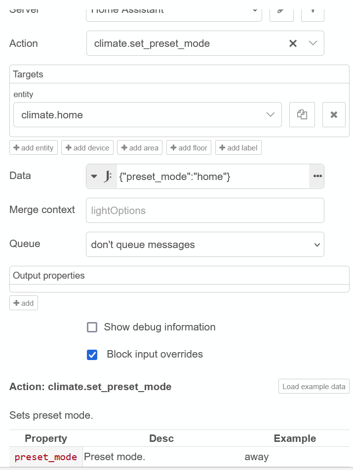

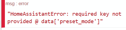

home needs to be in quotes "home"
^got the above in debug after adding the quotes
node settings ^
It’s adjustable in a dashboard card^
That’s helpful to see that about the domain, alot of search results point to threads that are 2015-2022 and don’t have this “newer” Action node, but these Service Call nodes that have Domain in it (and threads for this ecobee thermostat talk about a Developer API key that no longer exists, but i found some talking about using Homekit, which is how mine is added)
The climate.set_preset_mode didn’t work once I updated the syntax per your recommendation (see alternate response)
