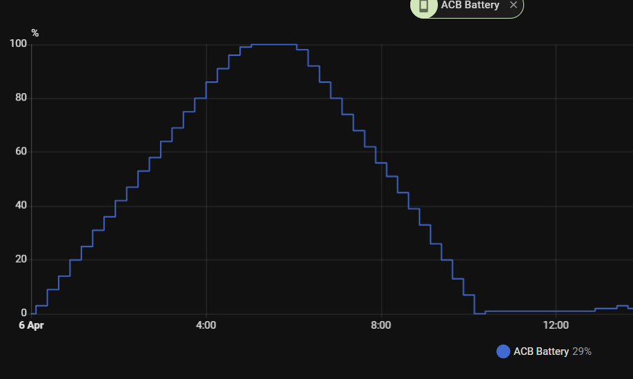

I have an Enphase system with an older AC Battery (ACB - part 800-00930-r03), which is NOT the same as the newer IQ Battery. Getting this confused with IQ Battery support is a common pitfall so worth stating upfront.
The problem
The Enphase tariff scheduler has no concept of “hold” - once the overnight grid charge window closes at 06:00, the battery immediately starts self-consumption discharge regardless of any peak window you configure. There is no way to prevent this via the Enlighten UI or Installer Toolkit.

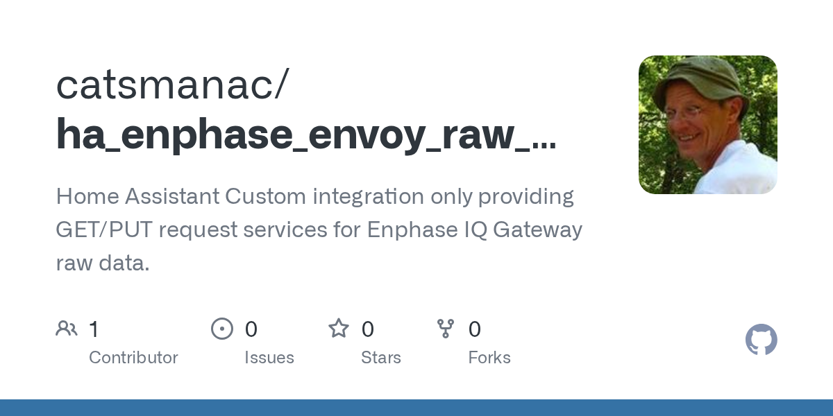

Below custom integration can be used next to the core integration, uses the same library as the core integration and provides 2 actions/services to read or write Envoy endpoints.
Before we can extend the core integration with the requested functions, we need more detailed data. Above custom integration enables you to request Envoy data from /admin/lib/acb_config.json.
Once configured you can use settings / developers tools / actions and configure something like
action: enphase_envoy_raw_data.read_data
  endpoint: /admin/lib/acb_config.json
  config_entry_id: 01KMZMGA4EF2C68G9AFX6P3ZBM
which will return the data in the output pane.
Curious about what data is returned during various setups you use. Does it always shows all existing ACB serial-nums? We currently have no individual ACB data, only aggregated. So coming up with serials might not be straight forward.
Other question is if the .json is needed in the endpoint spec of if /admin/lib/acb_config works as well.
The custom integration also allows to send PUT data to the Envoy. I also added a DELETE choice as that seems needed as well. Needless to say that sending data to the Envoy is “handle with care” and can be risky. I have no experience with that endpoint, so any risk is yours.

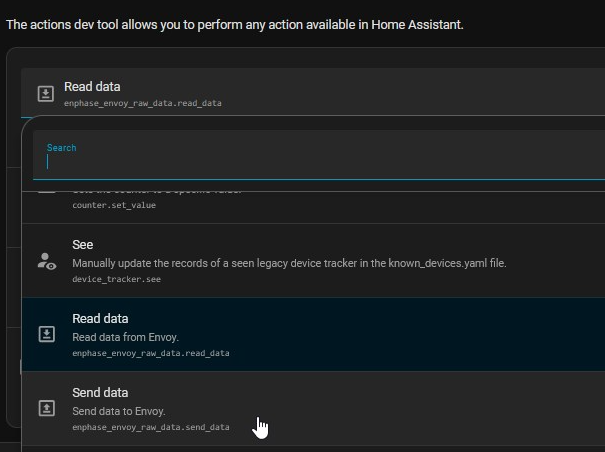

Did some backlog cleanup on the enphase_envow_raw_data custom integration and added a devcontainer setup using the custom integration blueprint.
To test you ACB Sleep with a running HA instance, install the custom integration by adding it as a custom library in HACS. Then configure the custom integration and add your Envoy. The custom integration does NOT replace the core one or any other cusom intgeration, but runs as a separate one named enphase_envow_raw_data.
To see if your ACB seep mode actually works go to Settings / Developers tools / Actions. Select GUI or yaml mode as you prefer. On your very first one, best start in GUI mode to easily select the config_id of the Envoy. Once you have that id you can use either mode.
For action select enphase_envoy_raw_data.send_data. For endpoint use the endpoint you mentioned: /admin/lib/acb_config.json. For data use what you want to test for this sleep mode. The example shows {"acb_sleep": [{"serial_num": 12345, "sleep_min_soc": 0, "sleep_max_soc": 100}]}. I assume you need to add one serial_num line for each battery you have, or send these in separate actions.

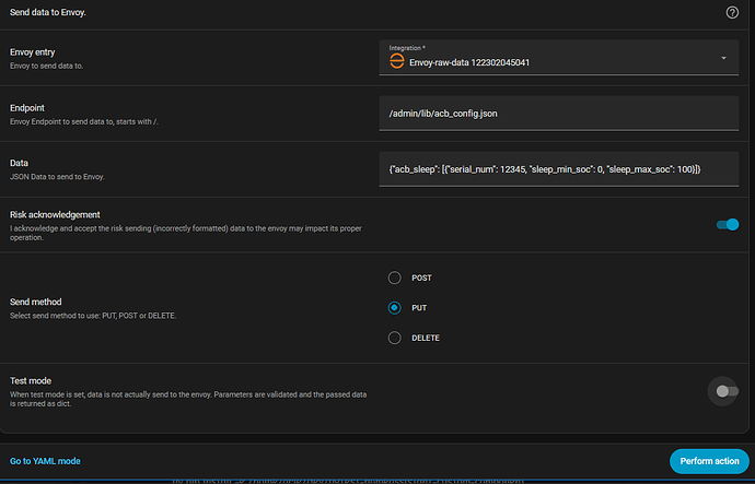

The full yaml for the example would be:
action: enphase_envoy_raw_data.send_data
  risk_acknowledged: false
  method: PUT
  test_mode: true
  config_entry_id: 01KN7PTDNZN3S6DVR47NB4KBA0
  data: >-
The config_entry_id should of course be yours, mind the risk_acknowledge setting safety guard. should be yes or it won’t execute. Also mind the test_method setting, if true it will not actually send the data but just return the data you want to send. Simple test method for mistakes in data formats and alike.
For the Delete you also need, change the method to DELETE and the data to what is required for the delete action.
GUI format screenshot for this:

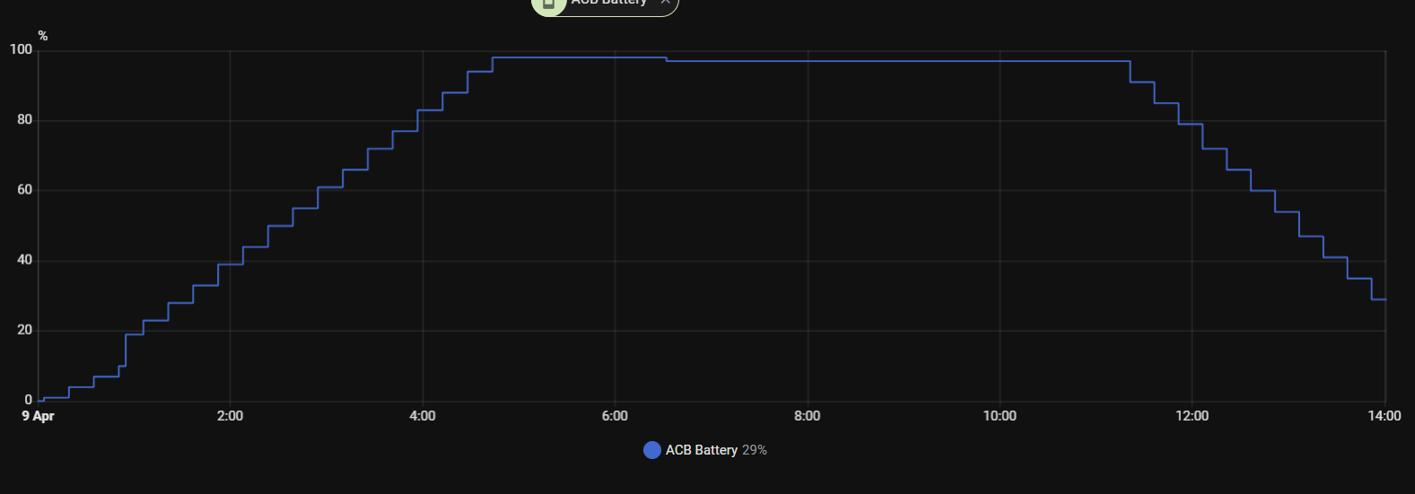

For ref, I have also created a Enphase AC Battery Enlighten Capture Summary with the cloud endpoints here: [Device support]: AC Battery (ACB): Add sleep mode control entities · Issue #464 · barneyonline/ha-enphase-energy · GitHub
It’s just for refrence, as i’m more intrested in local polling.

As for the enphase_envow_raw_data integration, you can use the actions you tested also in automations. In settings / automations & scenes / automations you can configure the actions needed to execute go-sleep or wake command. That will provide options to see how this best can be used.

I already have one quick Home Assistant automation that behaved well with a fixed high range. In my case it let the battery charge overnight on cheap energy and then hold that energy until I explicitly woke it later.
These two screenshots show the difference in observed SoC behavior over time:
Old (undesired behavior)
New good behavior (using sleep):
That means the immediate unknown is not just whether 5% adjacent ranges are the “correct” format, but whether the gateway actually cares much about the exact range at all as long as it accepts the request.

          - action: enphase_envoy_raw_data.send_data
              config_entry_id: <config_entry_id>
              method: PUT
              risk_acknowledged: true
              test_mode: false
                acb_sleep:
                  - serial_num: "<working_acb_serial>"
                    sleep_min_soc: 95
                    sleep_max_soc: 100
      - conditions:
          - condition: trigger
            id:
              - Release
        sequence:
              method: DELETE
              test_mode: false
                acb_sleep:
mode: single
In my case that was enough to get the battery to charge overnight, hold instead of discharging on its usual schedule, and then resume normal behavior once I sent the DELETE.

  • the remaining question is how strict the gateway really is about the sleep_min_soc and sleep_max_soc values
Ah, I see, thanks for educating me. Sounds as for now you have all the tools you need to research it.
@catsmanac I have opened a PR for the underlaying pyenphase libary to add per-device ACB inventory, sleep control, and devtools Add per-device ACB inventory, sleep control, and devtools by genestealer · Pull Request #428 · pyenphase/pyenphase · GitHub
