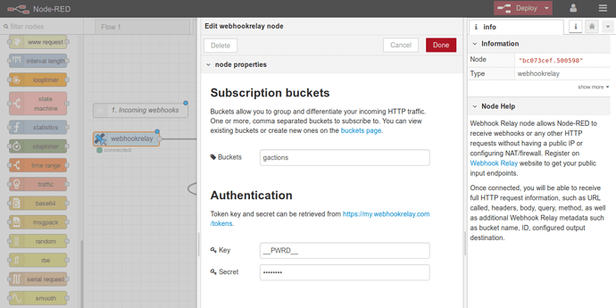

Let's get started. First, get authentication tokens and set them to the node-red-contrib-webhookrelay node. In the "Buckets" field, add our "gactions" bucket which we created previously:
