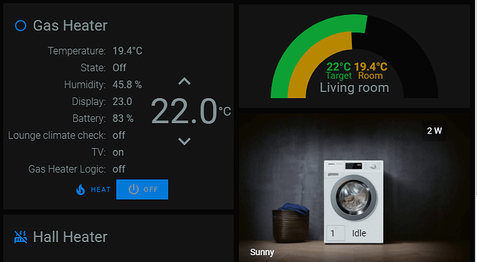

I got 3
of these
after watching this
working great

lovelace look
see clear as mud
hope this make cents
