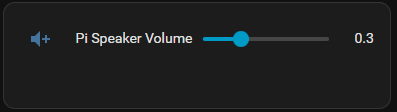

So, Here is the issue. The current Card code
type: entities
entities:
  - entity: input_number.pi_speaker_volume

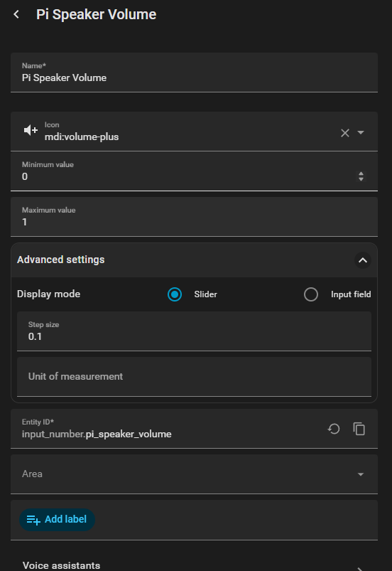

And the helper:
And finally the Automation for the slider
alias: Sync Pi Speaker Volume
description: Syncs the volume slider to the Pi Speaker
triggers:
  - entity_id: input_number.pi_speaker_volume
    trigger: state
conditions: []
actions:
  - delay:
      milliseconds: 200
  - action: media_player.volume_set
    metadata: {}
      volume_level: "{{ states('input_number.pi_speaker_volume') | float }}"
      entity_id: media_player.pi_speaker
    continue_on_error: true
mode: restart
max_exceeded: silent
Seems to work, ie, If I run the TTS script and move the slider volume goes up or down. No issue.
