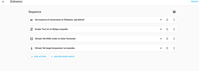

I have a script called “Dobranoc”:
As you can see, the first action is set_conversation_response. However, it does not work.
As you can see, it responds with generic “Uruchomiono skrypt” meaning “script was executed”. It also behaves exactly the same when using my Voice PE.

There’s no reason why it should work.
set_conversation_response is not a standalone service and is not used outside of custom sentences.
Okay, I think I misunderstood its purpose. Is there a way to make a custom reply for a script execution?
  • The easiest way is to make automations(custom sentences) for the script.
  • If the situation allows, you can explicitly specify notifications on the media player in the script.
  • Perhaps there are more complicated variants with obtaining the enity_id of the satellite in the script, but it looks overcomplicated
Works like a charm, thank you very much!
